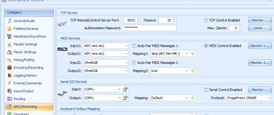

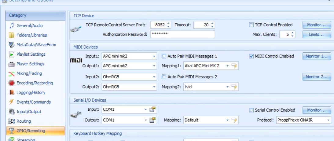

The leds from the buttons of the controllers akai apc mini mk2 and livid ohm rgb.
When i select in midi divices section input 1 and output 1 the akai and input 2 and output 2 the livid controller only the leds of the akai works.
As i put the livid on in and output 1 and the akai in in and output 2 only the livid controller have led feedback.
All the led commands are in the event/commands section do i need programm one controller to another channel ?

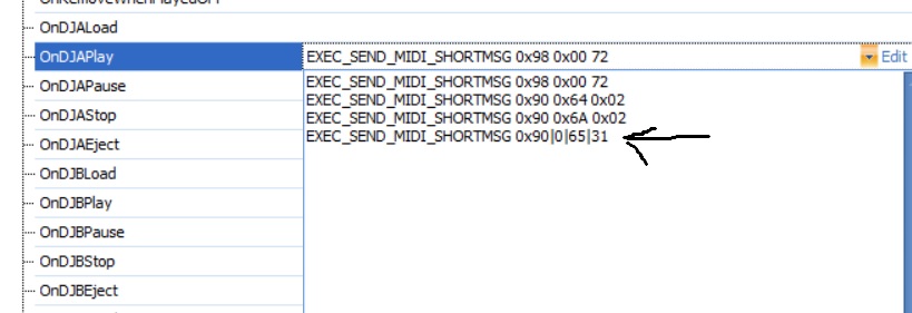

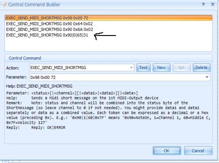

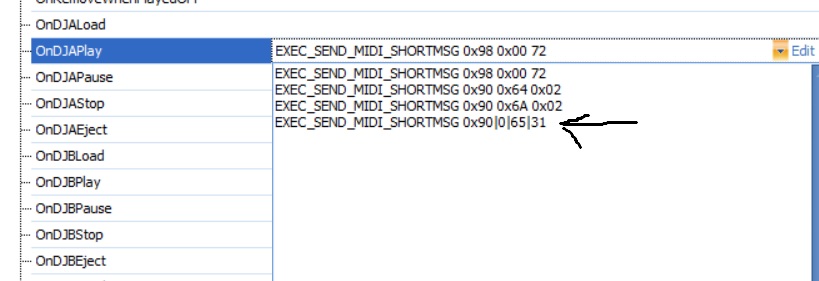

Can you send the control-command you are using (which is not working) and which events you are using to drive the leds?
Please send a screen-shot or text of the event/commands section.
Andre Kroon
Posts: 19
Joined: 21 Feb 2023 19:54
Re: Two midi controllers led feedback
Post by Andre Kroon »
The Livid controller is working but no led pads light up.
Pad is 65
Colour is 31 ( Red )
Posts: 9160
Note, that you must you use EXEC_SEND_MIDI2_SHORTMSG for the 2nd MIDI device.
In your events I only see commands for the 1st MIDI device.
I.e. EXEC_SEND_MIDI_SHORTMSG vs EXEC_SEND_MIDI2_SHORTMSG

Oke,thank you it works, i did'nt see that sorry.
