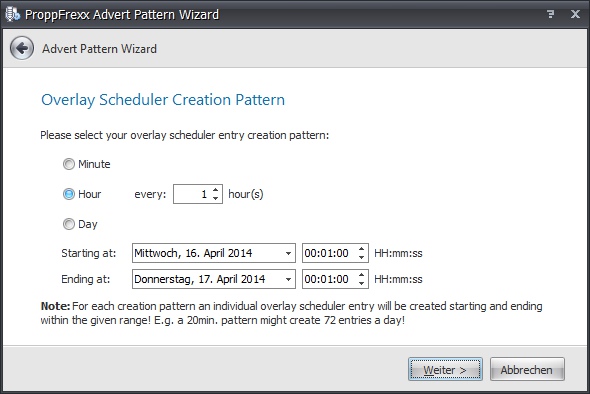

Just one question regarding the Advert wizard. What I normally do to plan a commercial overlay 'after the news'
- Pick an start and end date. Time : 00:01:00 (will be a 'soft start' later on in the dialog, to let it start after the news)
- Tick Hour, every 1 hour
-> Next

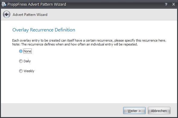

- Check none for overlay recurrence definition. As far as I understand, that way each overlay will be on it's own. So, no repeats, no double ones.
Correct ?
I don't understand why I would pick another recurrence definition, but maybe it's better to pick something else ? I can understand all parts of PFOA, but the overlay recurrence definition is somehow a mystery. Even when reading everything there is about it on the forum. Maybe I just think in another way ;)

That sounds totally correct !

Anyhow, here is a little sequence creating new entries manually (non-recurring).
Note, that the initial start and date/time range (Starting at/Ending at) spans exactly one day and within that day every hour a new entry is created...
But it is non-recurring:

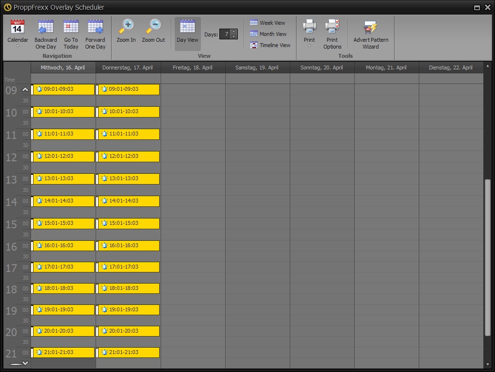

Finally the calendar might look like this:
Note, that I ran the same sequence as above twice:
1. Starting at/Ending at: 16.04.2014 00:01:00 / 17.04.2014 00:01:00
2. Starting at/Ending at: 17.04.2014 00:01:00 / 18.04.2014 00:01:00

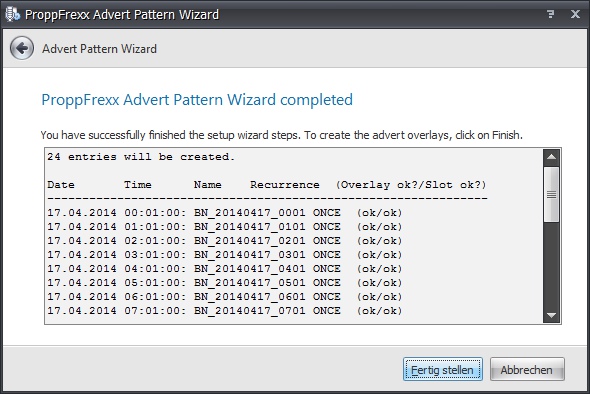

For each day 24 entries (one per hour) have been created!
Note the (ok/ok) in the final screen - there would have been 'conflict' entries in case of overlapping/duplicate entries - but if you overlook this and still click FINISH - duplicate conflicts might get created!
