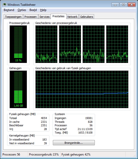

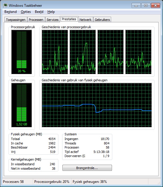

This is what happened with the memory use after a reboot of ProppFrexx
Below is the memory use before the reboot of ProppFrexx:
And this is the memory use after the reboot of ProppFrexx:
Notice the diference in 'Free' memory space is going up from 28mb before to 519mb after the reboot.
And as we speak it dropped about 100mb.
And it is still getting lower so I guess if I check back later the 'free' memory use would be back at 0-30mb again.
