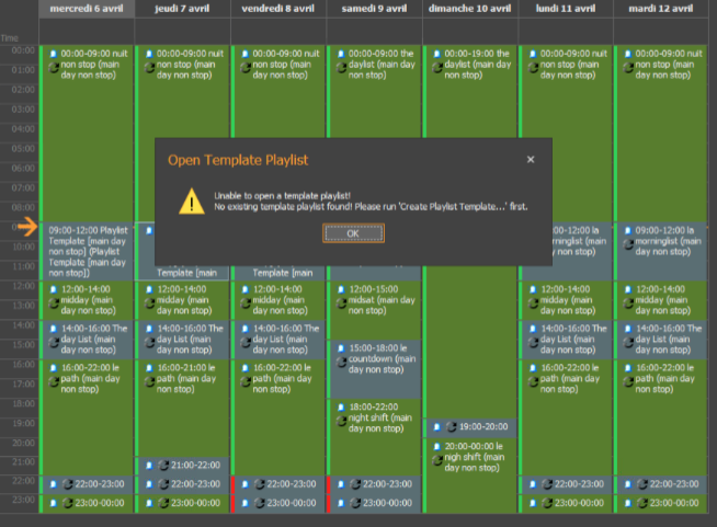

Last update of my definitely missed transfer from my previous computert to the new one...
3 hours of shows from 9>12, were voicetracked yesterday till friday.
Their playlists were generated from the scheduler and they were all 3 saved at the end.
This morning at 9 PFOA generated a new playlist and didn't started the previous VTracked one.
I found it in the recent history from the main window so I started it manually.
I tried to open the previous recorder 9>12 of tomorrow from the scheduler.
then i got that message:
- Capture d’écran 2016-04-06 à 09.16.19.png (240.26 KiB) Viewed 9820 times

about the eror message here are my way to get it.
I choose in the main playlist add/ insert an embeded container/from a script and then when i try to open the menu of scripts the error message show up.

Please send me your full Error.log file and the exact steps to reproduce, as currently I can not reproduce that here.
What exactly are your doing (a detailed step by step instruction until the above error happens...)
Re: bad vt folder
The message 'Unable to open a template playlist' - 'No existing template playlist found...' simply indicates what I already expected.... your .pfs script files 'LoadPlaylist' script-lines still point to an old path which doesn't exist on your new PC anymore!
Please send me the related .pfs script file or post a screenshot with the LoadPlaylist script-line entry and validate the path for that LoadPlaylist entry...

Yes, the issue is exactly what I have already written!
Open your script in the script editor - and you'll notice, that the first 'LoadPlaylist' script-line still references a path which doesn't exist anymore - as you are now using a different user path!
The LoadPlaylist script-line references the following playlist file:
\Users\thomas\AppData\Roaming\radio42\ProppFrexx ONAIR\4.0\plstmp\${start_yyyy}${start_MM}${start_dd}_${start_HH}${start_mm}\${start_yyyy}${start_MM}${start_dd}_${start_HH}${start_mm}.pfp
I assume this must now be:
\Users\playl\AppData\Roaming\radio42\ProppFrexx ONAIR\4.0\plstmp\${start_yyyy}${start_MM}${start_dd}_${start_HH}${start_mm}\${start_yyyy}${start_MM}${start_dd}_${start_HH}${start_mm}.pfp
