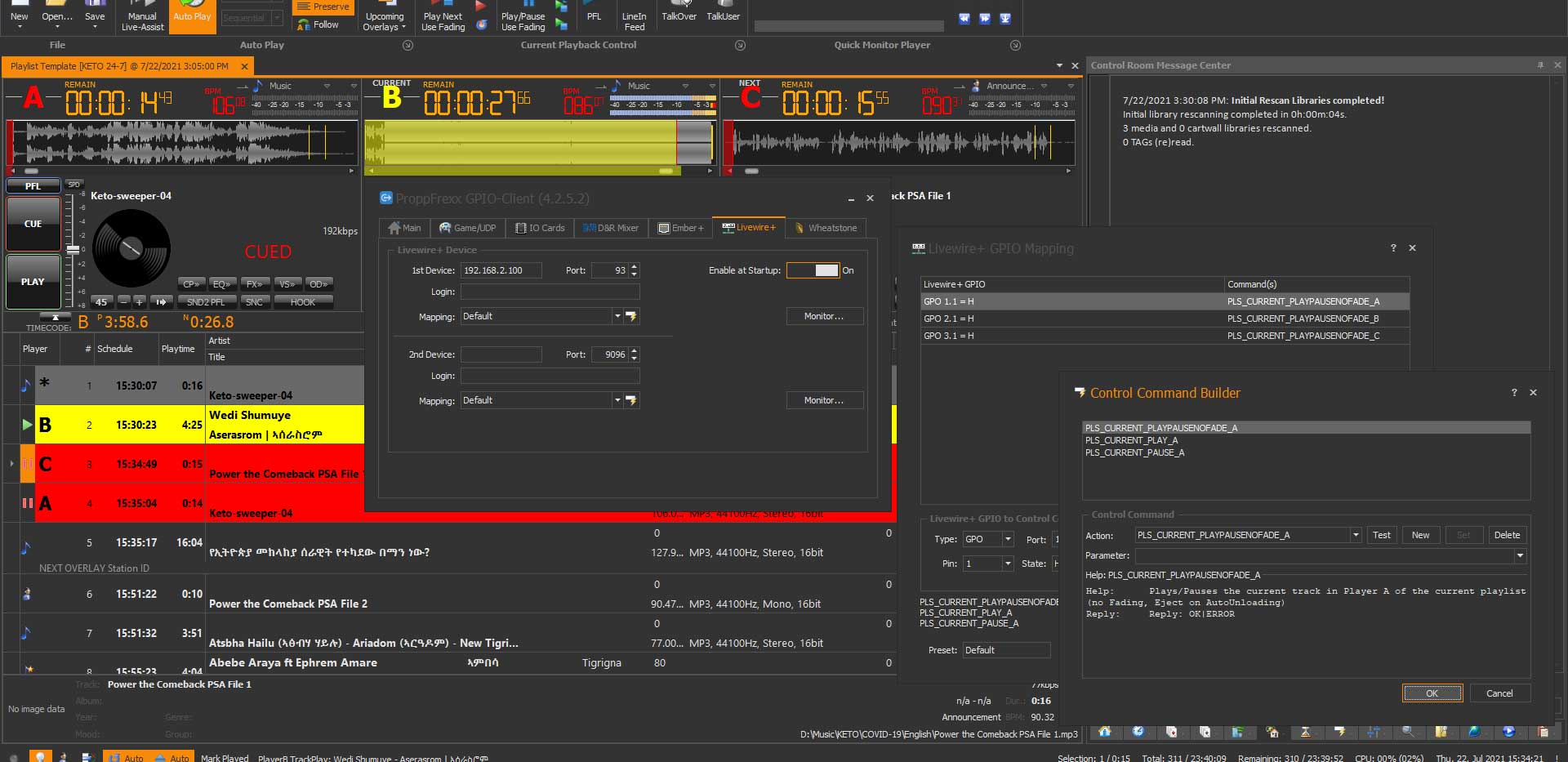

here is what i like to know
ProppFrexx GPIOClient Yes
GPIO Extension Service’ enabled
I want to execute a control-command for DJ A (player A)
I need to use my Axia feeder #3 for DJ A, #4 for DJ B and #5 for DJ C
so, now how do i setup my GPIO for DJ A ( to paly Cued or Pause in my Feder?)
how do the Axia know what i need to do?

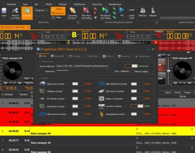

B) Have tried what I described in the above post?
Yes, did you see the screenshot

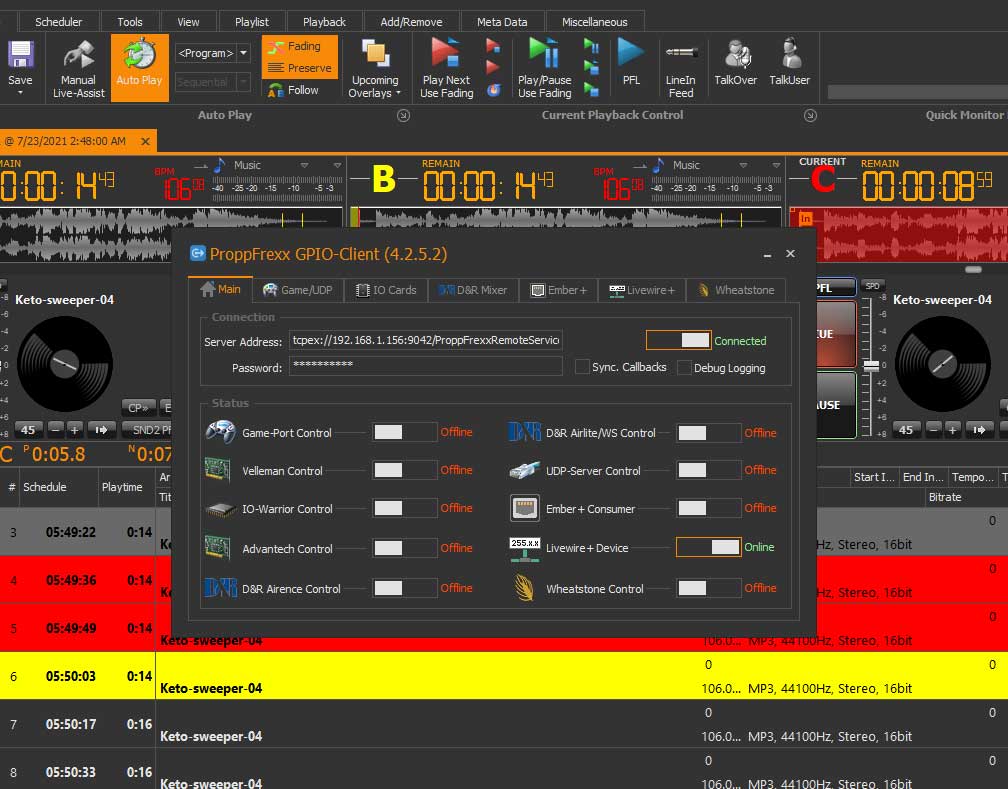

C) Is the “Livewire+ Device” option enabled on the Main tab?
Yes see my screenshot

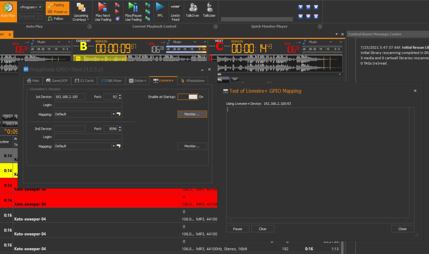

D) What exactly do you see (is the output) when you now click on the ‘Monitor’ button AND press a fader/button
see the screenshot nothing i dont see anyting

Re: Mixer Settings for use without console
A) I meant the version number, which needs to be v4.2.5.2 or higher
B) + C) thanks
D) If you do not see anything, it seems to be, that no GPO or GPI event is being triggered/send to ProppFrexx, which is maybe an Axia config issue.
The last link I did send you might clarify why this is, but in the end this needs to be solved by the Axia admin.
