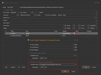

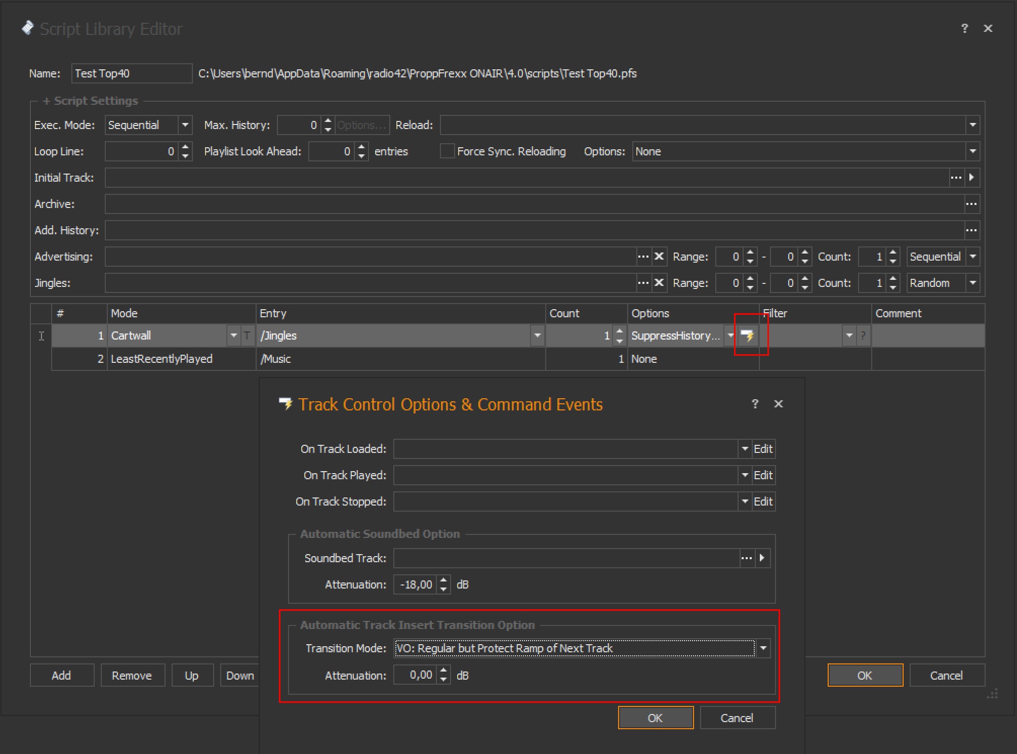

1. Create one Media Lib (e.g. a folder based, e.g. C:\PF\Music) which is then in the image below shown as /Music
2. Create one Cartwall Lib (e.g. a folder based, e.g. C:\PF\Jingles) which is then in the image below shown as /Jingles
3. Then create a script like shown in the picture below and create two script-lines as shown.
Click for the first line on the flash icon in the options column; and specify the options as shown in the picture... 4. Finally you can create a recurring program entry in the Program Scheduler (use the Schedulers button in the same ribbon to open the Program Scheduler) and use the script you just created in step 3.

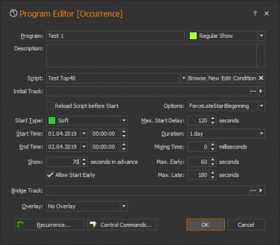

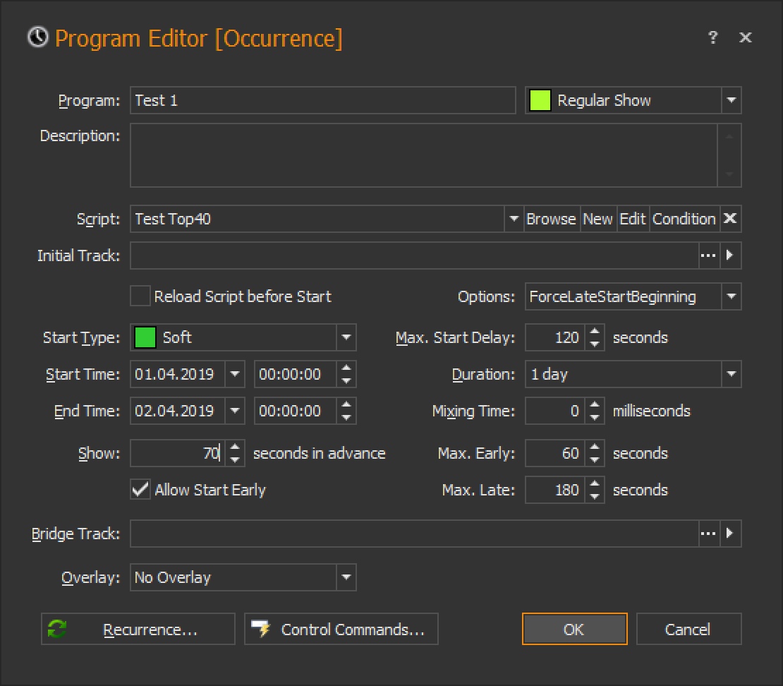

E.g. let this program run all day and set the Recurrence to Daily, every 1 day.
Make sure to set the Option: ForceLateStartBeginning
Like shown here: To start or stop the Scheduler click on the 'Run Scheduler' ribbon button... done.
