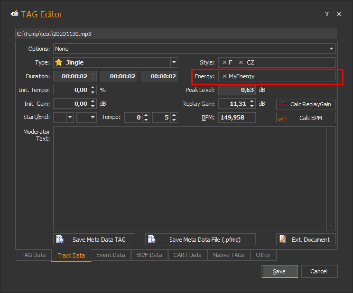

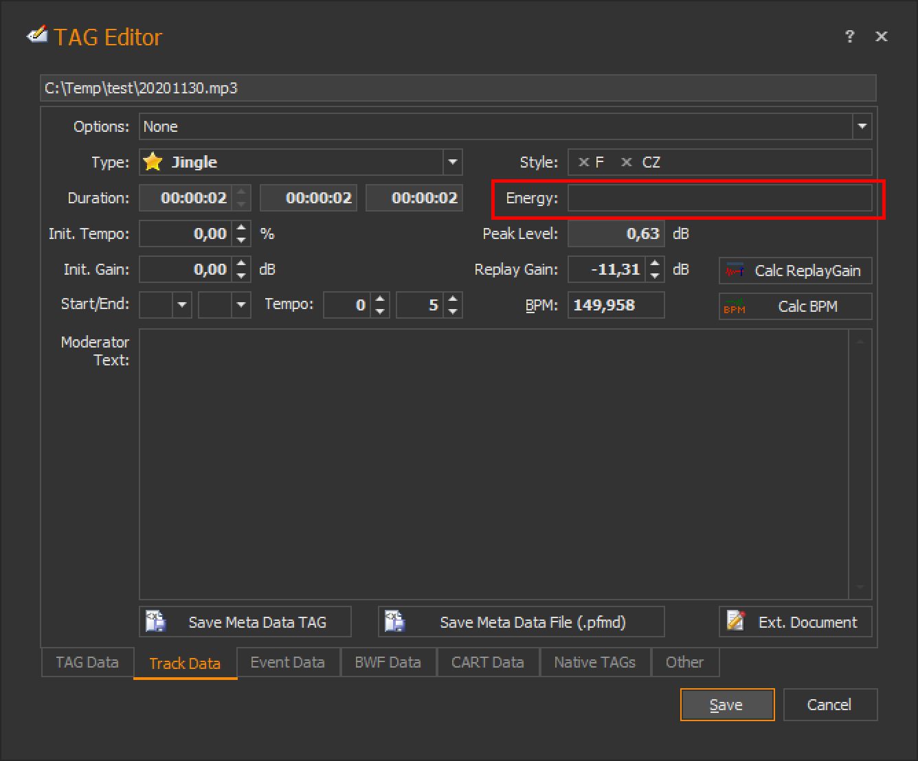

Unfortunately I can not reproduce your case. I.e. in my tests changing the Energy field works just fine (see the two screenshots). I followed your example as well as I even restarted the Tagger - the change is applied and all worked as expected. Maybe this is a local issue and your audio file is either corrupt or write protected? I tested this even with multiple files and that worked also fine.

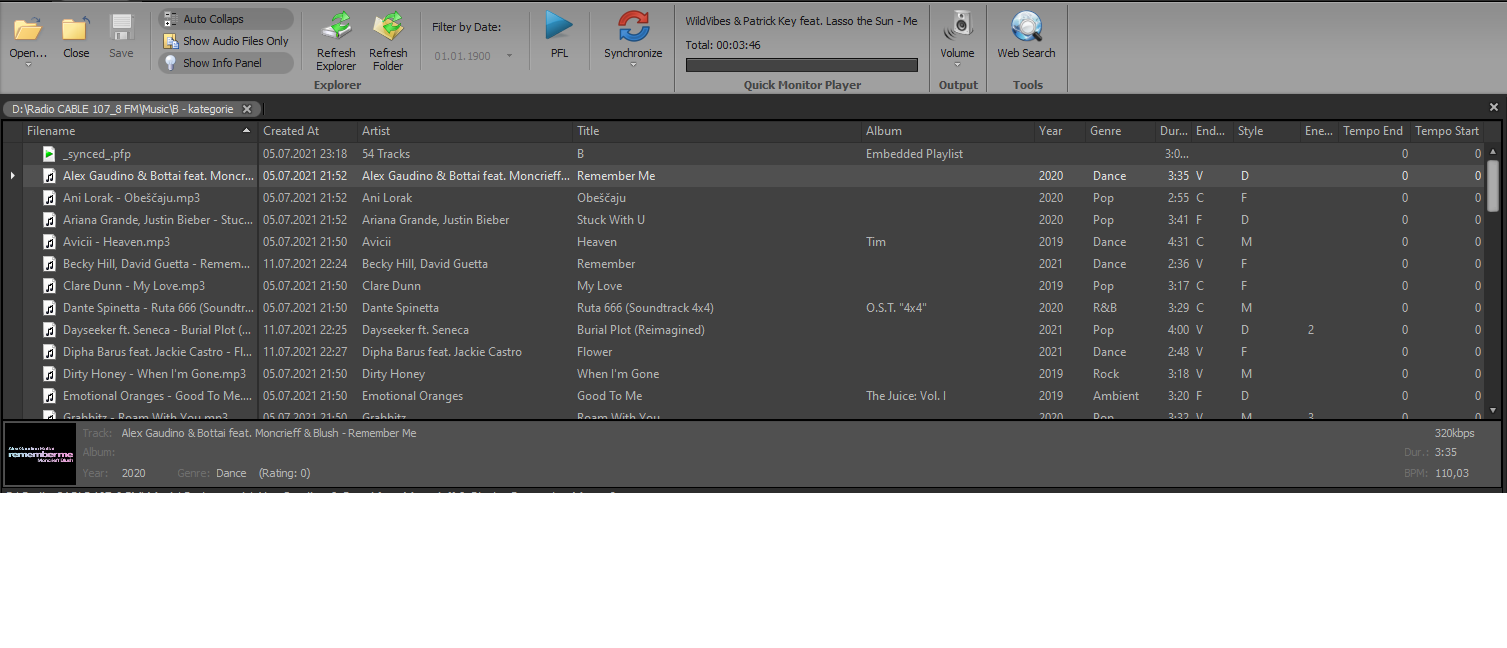

If I Use Alt+3 and edit Energy there, It's ok. When If I edit it in the list, it is not saved.
Re: Proppfrexx Tagger
Then (as written) it must be a different and completely other issue. Eg. write protection or corrupted files. Have you excluded those cases?!

Yes, I ruled that out. As I wrote - if I edit the TAG via Alt + 3, then Energy is saved. If I fill in Energy in the list of all tracks, it will not be saved. But all other parameters do.
Ahhh, now I got you - my mistake!
There was indeed a typo within the direct tag edit in the Explorer (List) view of the Tagger.
It is now also fixed in the v4.2.6.1-beta - so please 'Check for Beta-Versions...'

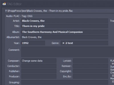

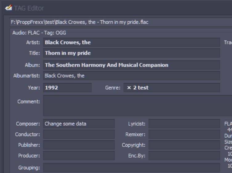

radio42 wrote: 05 Sep 2021 18:14 Fixed in v4.2.6.0!

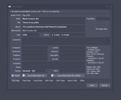

Bernd,
I'm sorry to inform you, you're solution doesn't work when one changes some info after initialy setting the data:
picture 1. Open ProppFrexx Tagger and apply the tag's.

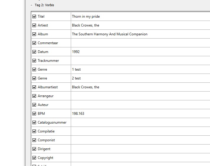

picture 2. Check de correct tag's in a different program.

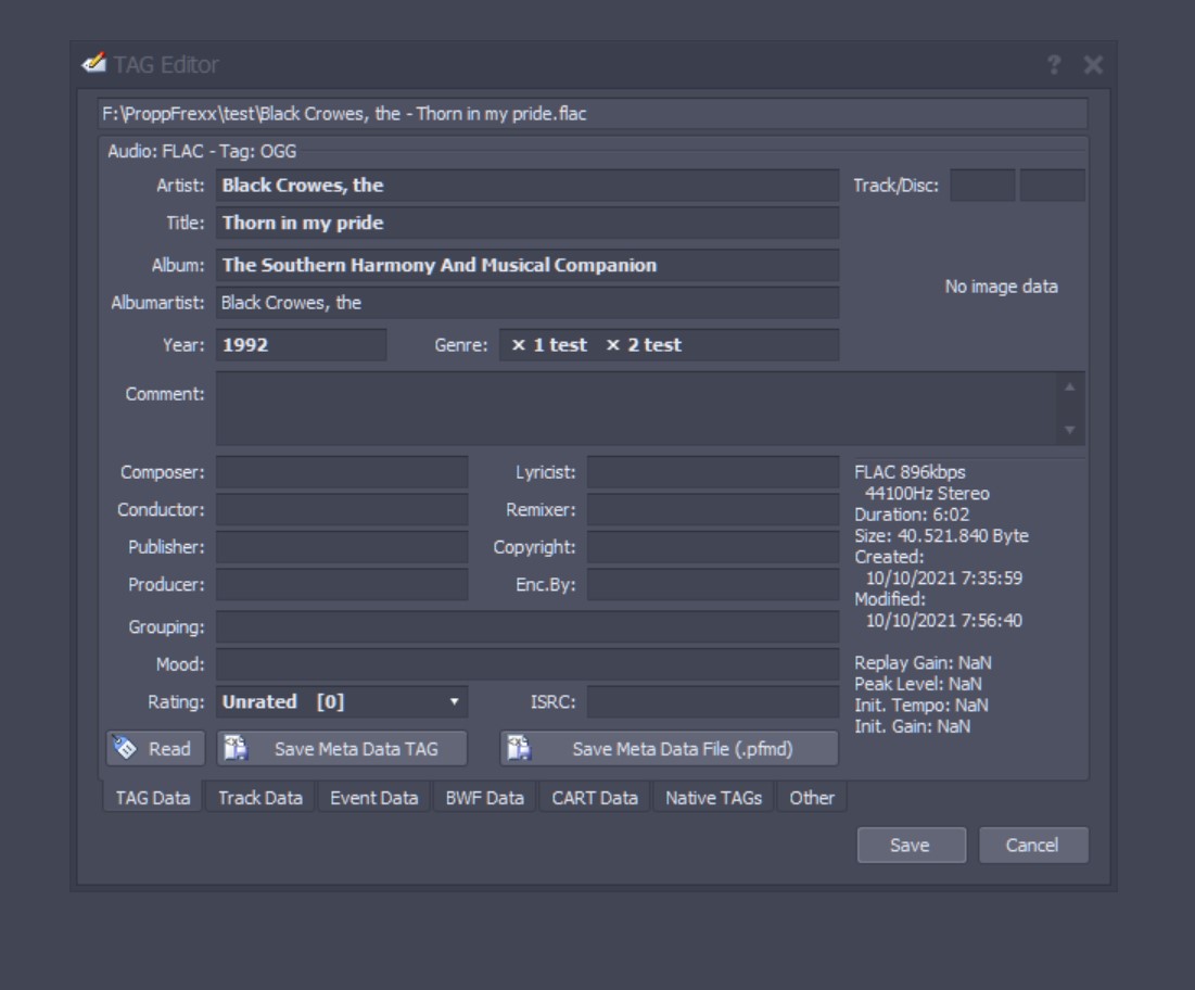

picture 3. Open ProppFrexx Tagger once again to change other information.
ProppFrexx Tagger only read the last added tag. If you save now, all tag's will be erased except the last added one.
I am currently on holiday, so I can only double check next week. But I assume you mean the Genre only and not any TAG?!
Note, that this sounds like a different issue you are having than reported here?!
However, I have to check, as I am not aware of such issue.
Peter Maerlandt
Posts: 32
Joined: 27 Sep 2020 14:22
Location: Wielsbeke
Post by Peter Maerlandt »
I'm not sure what you mean by 'tag'. My problem is that PF Tagger only reads the last added notice in 'Genre'. Don't think of it during your holiday, have fun.
