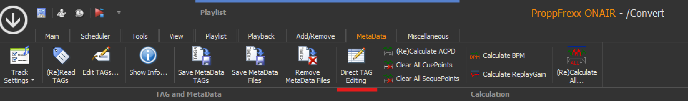

You might want to enable 'Direct TAG Editing'. If enabled, you have the same functionality like in the Tagger. At the end, don't forget to disable it again.##

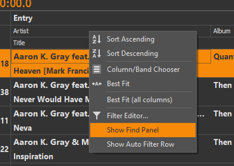

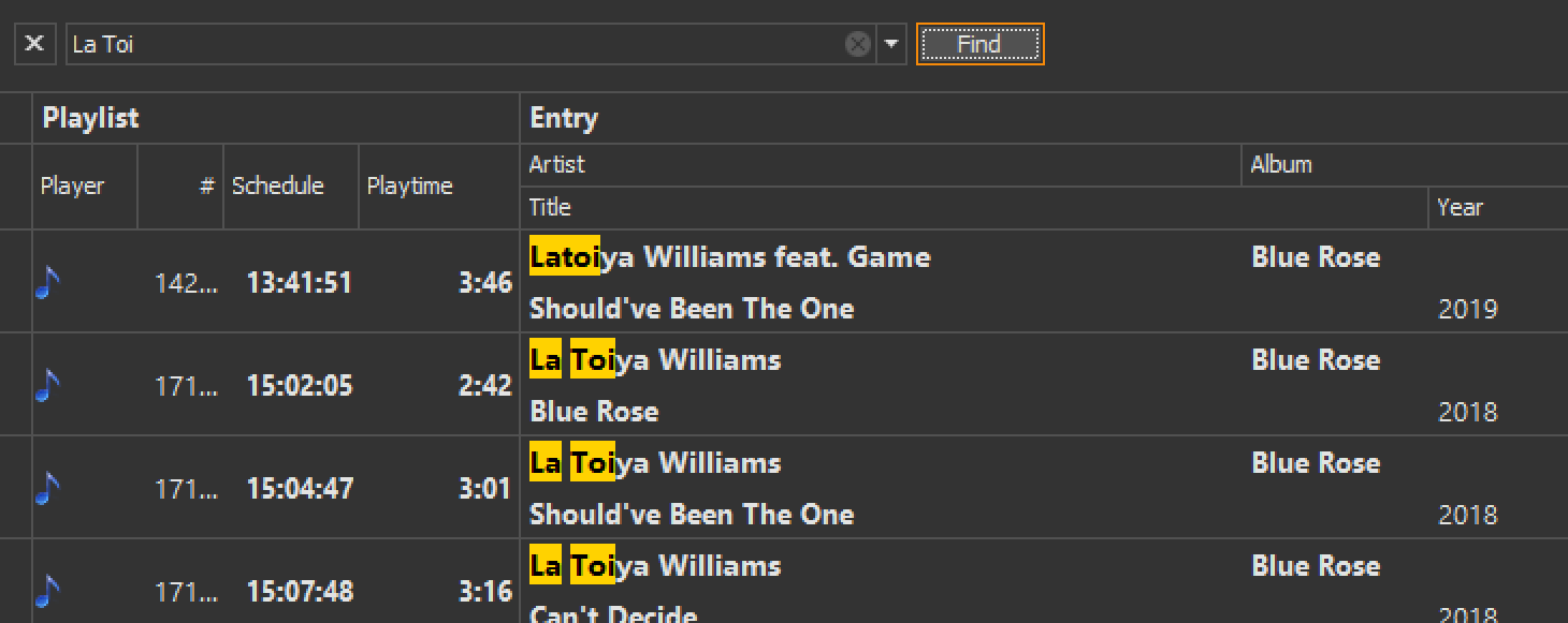

Or activate the 'Find Panel' from the column header context-menu (make a right-click on a column-header):
