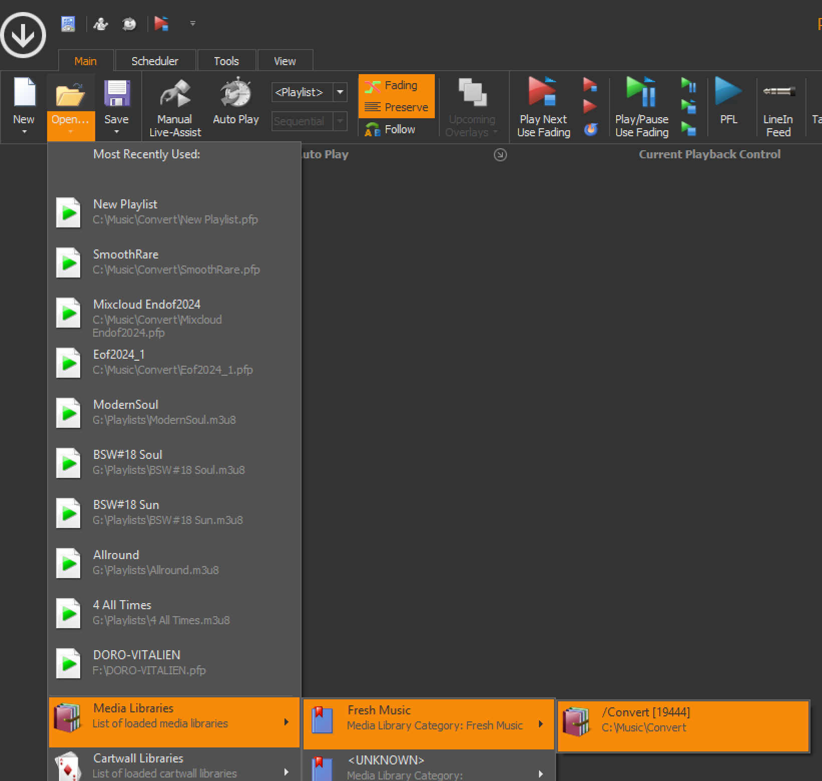

You click on the lower part of the "Open" in the Main ribbon tab.
This opens a sub-menu with the list of most recent playlists pus at the end of that list the "Media Libraries" sub-menu, from which you can now open you related media library directly.
This now opens a playlist window reflecting your media library. In case of folder based media libraries a (actually 2) warning dialogs appear to inform you, that if you drop/add new tracks, those tracks won't be saved/copied to your folder structure and as such not saved.
But if you tag your files them from here, no rescan is needed.
