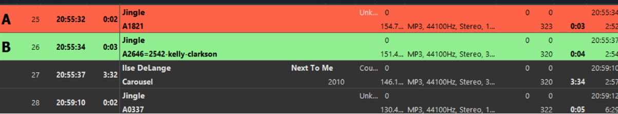

No, the StationVoices are not in the cartwall. As you can see in the screenshot below, there is a StationVoice after a jingle in the playlist. According to the script, that is not possible — a maximum of one jingle can be played between two songs. Therefore, I believe it can hardly be anything other than a StationVoice.

I am not talking about your cartwall! I am talking about your regular media libraries.

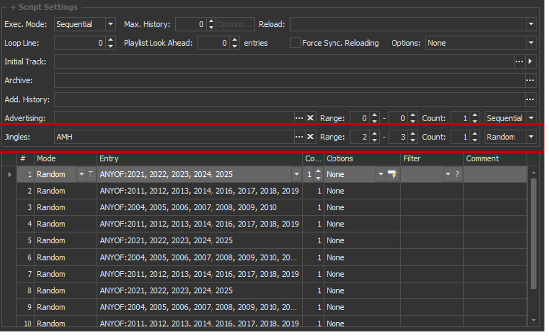

You have defined (according to the debug log) a following script-line:
Script-Line 6: Random : ANYOF:2004, 2005, 2006, 2007, 2008, 2009, 2010, 2011, 2012, 2013, 2014, 2016, 2017, 2018, 2019
And this script-line returns the 'track' "Jingle - A2623-pink" !
So in the playlist this is a regular script track and NOT a station voice file! But you assume, that this entry is a StationVoice file and as such that the related track from PINK is missing.
But it is not missing anything, as your "Jingle - A2623-pink" is contained as a normal track in your media library.
Please add the column 'Source Info' to your playlist and you can even monitor, from where a playlist entry is originating.
