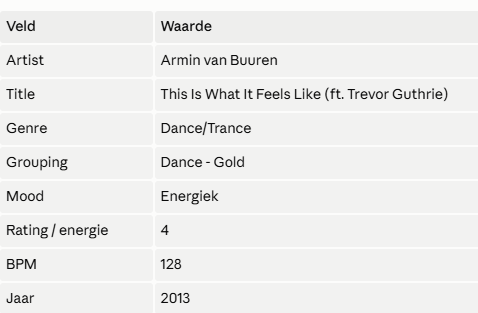

one question : How wil you these tagging : Armin Van Buuren Ft. Trevor Guthrie - This Is What It Feels Like the ft option, what is the best way. and orret mood tag. i thin energiek 4/5 melancholisch as moodtag?.

Re: correct media libary
No i dont have anny iseu, but i start my database from zerro to al songs. i want just good tagging, the proppfrexx tagger works on laptop extend but witch file do i need to the music server kopied?. only the pfpfiles. i work on the laptop with usb for al my song database. i hope you understand me is the ft. in the artiest field also correct way?.radio42 wrote: 13 Aug 2026 06:55 Yes, that is fine as well.
Tagging should be don’t direct in the audio files! Nothing to copy.
Just rescan the folder libs in ProppFrexx OnAir or do the tagging also directly with ProppFrexx OnAir.

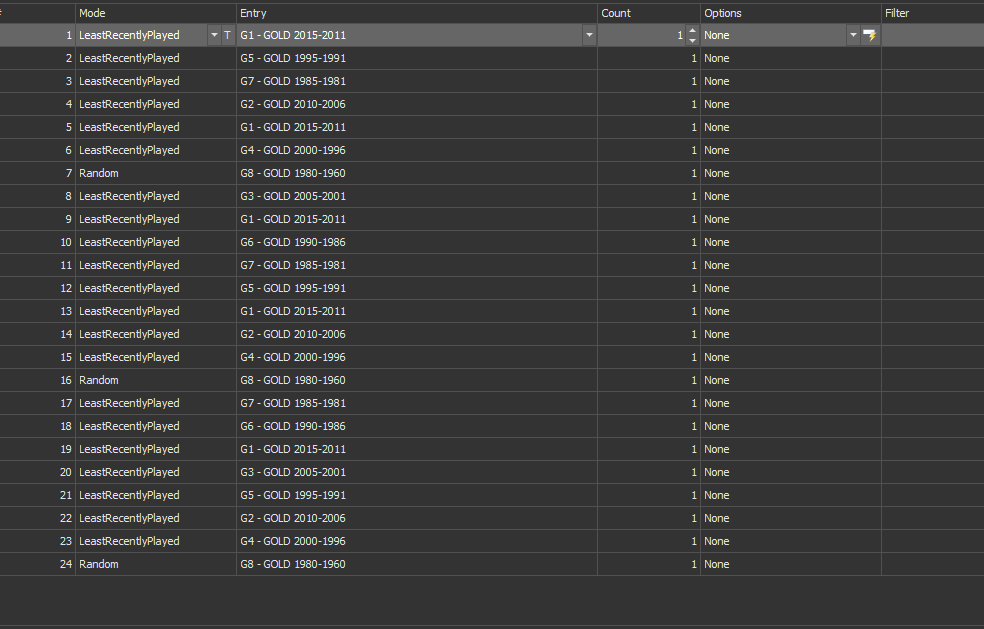

H eplays now every ouwer the same database, the opener is also a song from 2015-2011. i want randam plays on all mapps and used with mood tagging and grouping. whats the beste way to do.
It plays from the same media libs yes.
But the resulting playlists are for sure different.
If you want to consider mood or grouping you can use the Filter option in the script lines.
