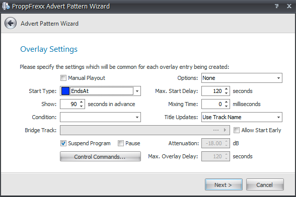

One more question regarding the bridge track. I'm setting up new commercial overlays and when entering the EndsAt-one to play before the top-of-the-hour (as discussed in this thread earlier), it doesn't allow me to pick a bridge track. I can pick one, when changing the type of overlay to one of the other options (fixed, soft).
Bridge track EndsAt.png (35.97 KiB) Viewed 8830 times
So, as far as I see I'm not able to use a bridge track before a EndsAt-overlay ?

Re: End of an hour fill option
Oh yes, that seems to be a bug in the 'Advert Pattern Wizard' not correctly enabling the bridge track field.
Please use the regular Overlay Scheduler to edit the Bridge Track field as a workaround.
It will be fixed in the next version.
