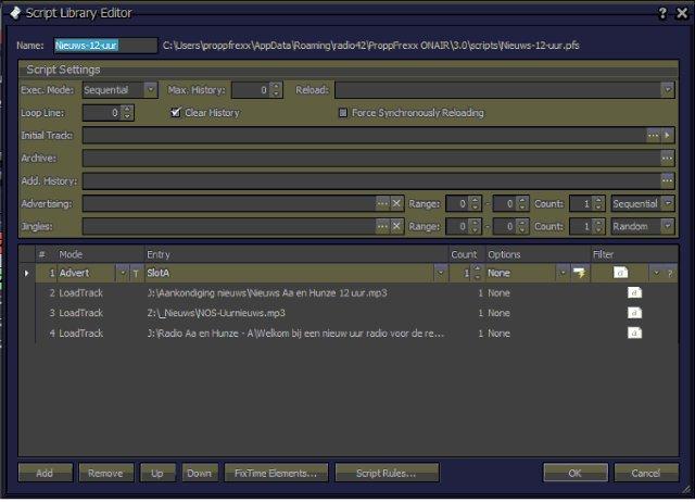

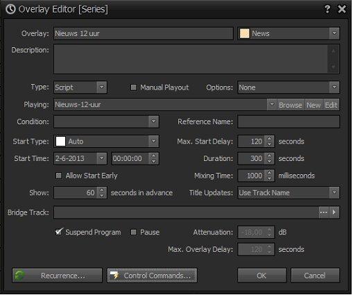

I have changed some things. But every time the news runs over the music. At 12.00 this day, a song was ended commercials were started and at the same time the music started. What is going wrong. As attachment the screen shots of de overlayscheduler and the script.

I'll take a detailed look and try to reproduce the issue here...
Just one note:
You should definitely set the "SupressHistoryCheck" and "SupressAddHistory" option with the given script-lines!
Else 'Advert' and 'LoadTrack' might not be played, if the global history check fails!

Just one note:

Re: Music over overlay and Explorer window is gone
I have seriously retested it and I can not reproduce your issue.
So it must be some settings you are using.
The only thing I can think of is, that you might use any control-command somewhere, so that the AutoPlay or PlayNext command is issued.
Else it wouldn't be possible.
If nothing helps, we might do a remote TeamViewer session, so that I can take a look at your system and setting and that you can demo me your issue live...

Hello Mart,
I saw you post on radioforum, but since they disabled my account there when i updated my email address, i decided to leave a reply here.
I have had the same issue with the overlay player starting the playlist after starting the overlay.
My troubleshoot was done with the following questions:
> Does this happen on random occasions?
And even if it does seem to, isn't is happening on a certain day on a certain time evertime.
I saw you mentioning 14.00 hrs and 12.00 hrs. In my situation, is looked like is was happening randomly, but after carefully logging is was only at xx hrs on day xx and the other occasions were day yy and hour yy.
> Is there any other form of scripting/controlling done in overlays?
For example, if the control command somewhere says " on Started" a command like PLS_Current_PLaynext, you trigger the playout from within an overlay item.
Furthermore it is sometimes neccesary to overlap sequential overlays, with the second on soft start. When there is a gap between 2 overlay playouts, the playlist could be triggered and proppfrexx doesn't end the track when a fadein is running.
I might have found an issue, if an overlay is starting exactly while the current track just fades-in at that moment.
This issue will be resolved in the next version!
However, 'AutoPlay' should have been disabled regardless...as such it might only be the current track which continues to play in that case...and it is a very rare case...

Please test the new v3.0.12.5 - which should fix your issues!
