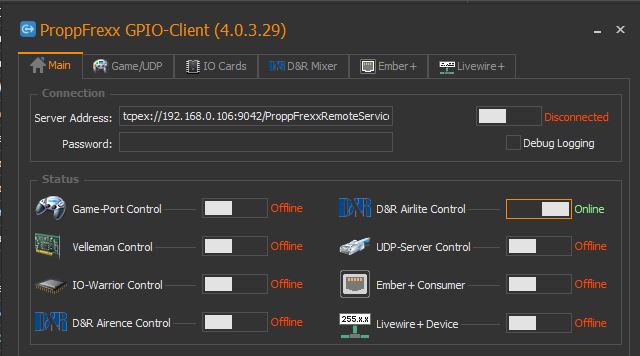

And again the GPIO-client asks for a password and the server address changes and the contact with the Airlite has been disconnected.
I'm sorry to note that the problems have started after a recent update of PF or Windows last week. For months, everything has worked well, but since the GPIO-client asked for a password it's hopeless.

Re: GPIO en Cartwall problem
Look at your posts above. The issue seems to be there in .23 as well and not only in the last version.
Maybe there are 2 different issues in your case.
As it only happens with your systems and not with all users typically indicates, that it is something specific. If we would know what we would have the solution.
When you say the server address always changes. What do you mean by this?!?
(funny even, that above you have written, that the main connect slider stays connected, but in your screenshot it is disconnected)
Where does it change and from what address to which address does it always change?
Is the IP address in your above screenshot changing resp. needs to change?
If yes, the IP address of your server (ProppFrexx ONAIR instance) seems to constantly change - which would explain the error message in the log.
To see, if it was really the last ProppFrexx update, you can go back to the 'Previous Version' - note the sub-directory (with the same name) in your installation folder. You might simply close all and copy all files up by one directory from this 'Previous Version' folder - as it contains a backup of all latest version executables.
