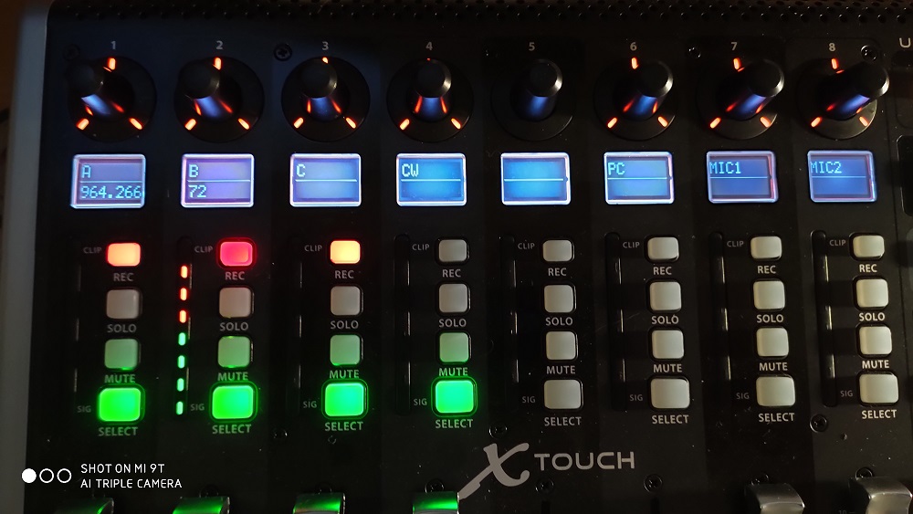

Command:
EXEC_SEND_MIDI_SYSEXMSG 0xF0 0x00 0x00 0x66 0x14 0x12 0x00 "*[STRING:{${outputmixer1name}}:{rpad}:{6}] " "*[STRING:{${outputmixer2name}}:{rpad}:{6}] " "*[STRING:{${outputmixer3name}}:{rpad}:{6}] " "*[STRING:{${outputmixer4name}}:{rpad}:{6}] " " " "*[STRING:{${inputmixer4name}}:{rpad}:{6}] " "*[STRING:{${inputmixer1name}}:{rpad}:{6}] " "*[STRING:{${inputmixer2name}}:{rpad}:{6}] " "*[TOFLOAT:{${outputmixer1gain}:{0}:{0}:{centered}:{15}:{128}] " " " 0xF7
Displays:
Re: MCU lcd
