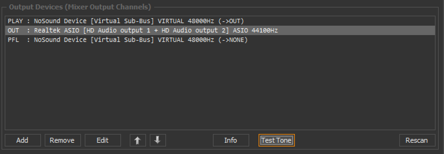

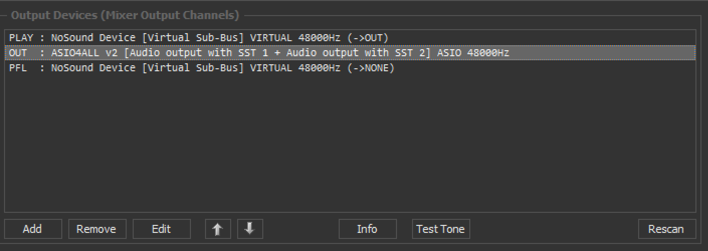

Here are 2 of my setups - they look absolutely the same as your, but I have no issues; I also don't get any similar reports from other customers. So that is indeed puzzling. But I have no idea what to so, as I can not reproduce the issue.
I guess you don't get any records in the "Error-log" file? You are also using the latest Asio4All v2.16?
Have you also tried the interneal RealtekASIO driver on Win11?
Just guessing in the dark, as said, I would have no idea, what could cause the issue in your hardware/OS.
