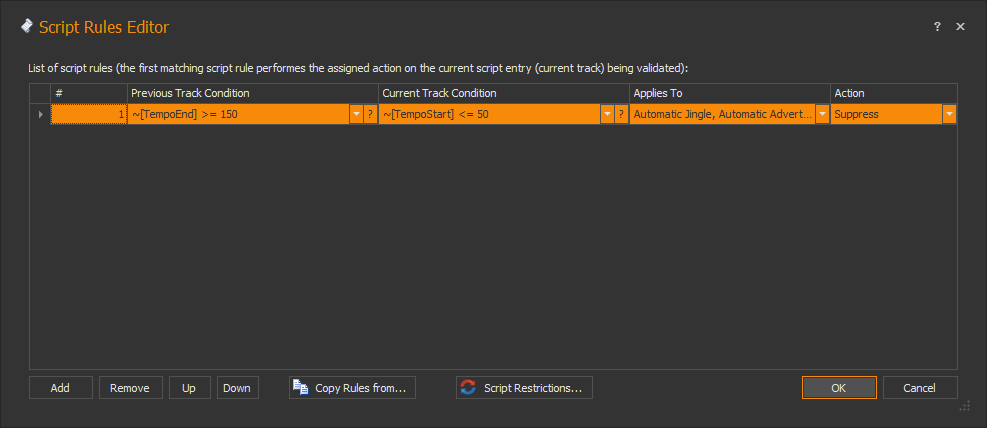

Pfff, I don't get it to work. Even with only one Script Rule line (see attached) the results are poor. I tried to include the test .txt file as an attachment but it does not work. How can I do this? Even the "UseLastTrackOnFinalFail" does not return any hits, so I end up with a playlist with skipped music tracks and double and even triple consecutive jingles. Without the Script Rule it works fine, all tracks are planned and there are no errors. Please help! :?

Please use the ‚Test...‘ function of the script.
You can directly email me that output to take a look at.
Posts: 9232
Re: Smooth track transition
One additional question: why did you add an ‚Additional History‘ to your script?! This references the global history, which is already checked!
So you should remove that option from your script.

OK. I thought that here the same history settings should be used as in the global history settings. So the script history settings should be set to "0" (Artist and minutes)?
