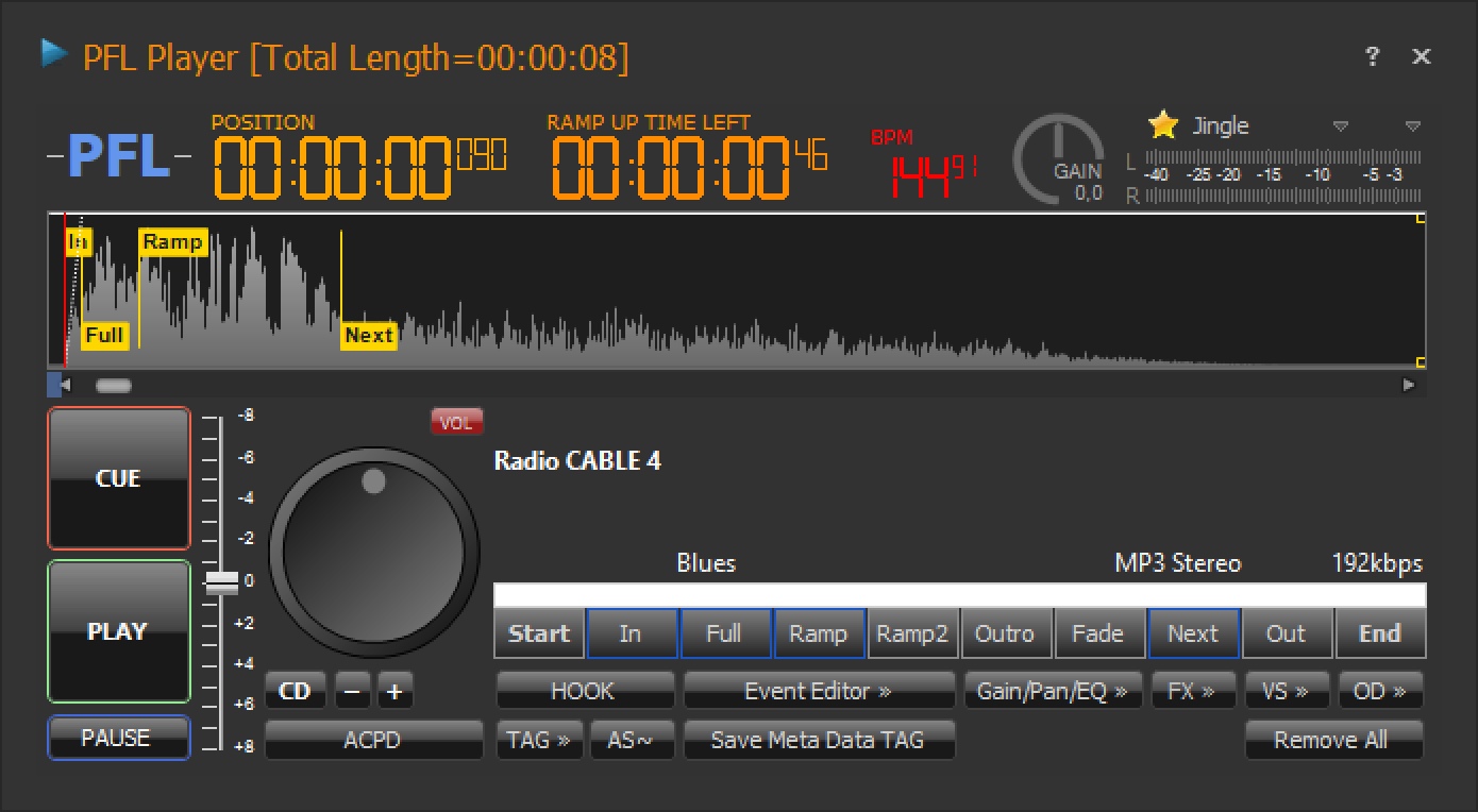

I have received your Test Playlist and Files and they work and play like expected. Please see the video in this link:
https://www.dropbox.com/s/rjsgdu193h2xq ... o.mp4?dl=0
The playlist starts with a 'Song', which plays normally (The Mix-In for Music is set to FullLevel).
The 2nd track is a Jingle (The Mix-In for Jingle is set to Ramp1). This Jingle has a Ramp cue-point set to around 500ms.This means, that the 2nd track should start 500ms in advance to the Next cue-point of the previsous Song, so that the Mix-In of that Jingle (the Ramp1 position) matched the Song's next cue-point.
In the video you can clearly see, that this is exactly what is happening - the Jingle starts playling slightly (500ms) before the next cue-point is reached!
The next segue Jingle to 3rd Song is also performed exactly as expected.
The Mix-In for Music is set to Full-Level. As for the song, cue-in and full-level are almost located to the same position, the alignment is almost not noticeable - but also here does the 3rd song start a few milliseconds in advance to match Next and FullLevel.
For the further segue with the next Jingle, this time the Jingle starts exactly with the next cue-point, as that Jingle simply has no Ramp1 defined! As such, it starts normally matching cue-in.
To conclude: All plays normally and as expected.
If it plays differently on your side, please explain and also provide a quick video to see where the difference is.
