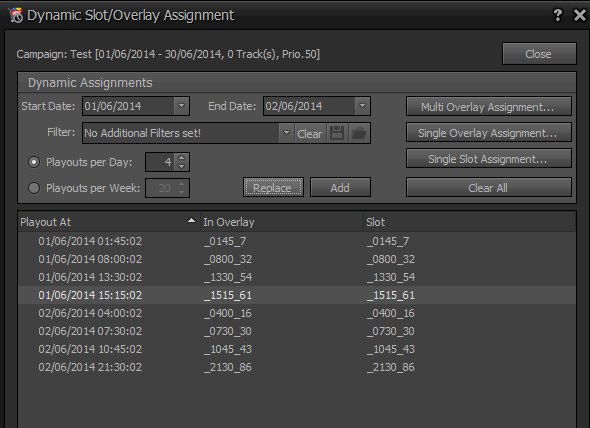

I 've just added some dynamic slot assignments:
2014-05-31 (1).png (28.89 KiB) Viewed 7082 times

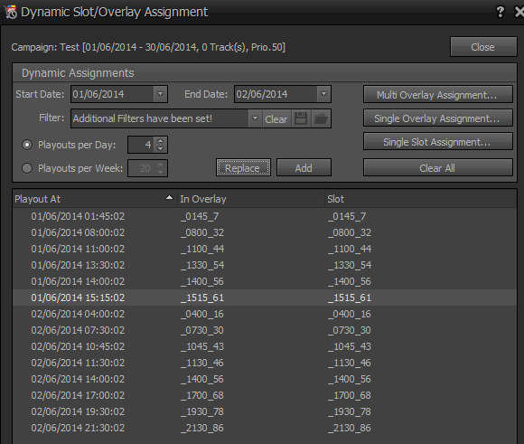

Then I choose a filter:
2014-05-31 (2).png (32.74 KiB) Viewed 7082 times

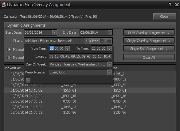

And hit replace:
2014-05-31 (3).png (30.75 KiB) Viewed 7082 times
New slots are added instead of replacing the current ones.

The 'Replace' button does delete any previously dynamically assigned overlays, which do match the current filter and date range.
As such, if your date range or your current filter doesn't match the already assigned overlays, they will not be deleted.
If you want to replace ALL, you first have to use the 'Clear All' button.
I guess in your case, you used a different filter as the initial assigned once?!
