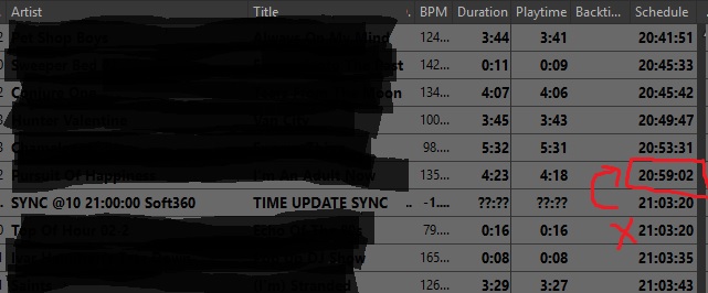

Sorry to revive this topic - but the suggested solution of starting each program at 1 minute to the hour did not produce desired results. Mainly because TryEnsureExactLength function is too good - and the result was that 90% of my programs did end up starting at 1 minute to the hour.
I'm attaching a screenshot of the playlist that just happened. Each program is 1 hour long and starts at the top of the hour. In the example below, the script tried to find a track of 58 seconds long to place in the 20:59:02 position - which of course it couldn't find ... so the result was a 4 minute track being queued, throwing off the next hour's clock by 3 minutes. I would never cutoff a song once it started playing - that's out of the question for me (i.e. MaxStartDelay is set to 6 minutes to prevent this from happening).
example
example
I would really love to have the ability to allow the next program to start early (based on user defined time threshold). In this case, a 1 minute early start threshold would have worked. When the script was not able to find a track of 58 seconds long to complete the hour it should have started the next program at 20:59:02 instead of pushing back the next hour by full 3 minutes. Again the threshold should be user defined (i think 1-2 minutes would work best given that most radio edits are around 3 minutes in length).
I'm a perfectionist when it comes to programming. Granted, this scenario occurs fairly rarely, however this time it really bothered me because it screwed up the next hour's playlist that was timed to be exactly 1 hour long (dropped the final track).

and here's an example 2 hours later where the scheduler worked perfectly. 2:56 track was queued to play at 22:59:59. However, even though the next hour is showing as being scheduled to start at 23:02:55 - it actually started at 22:59:59.
