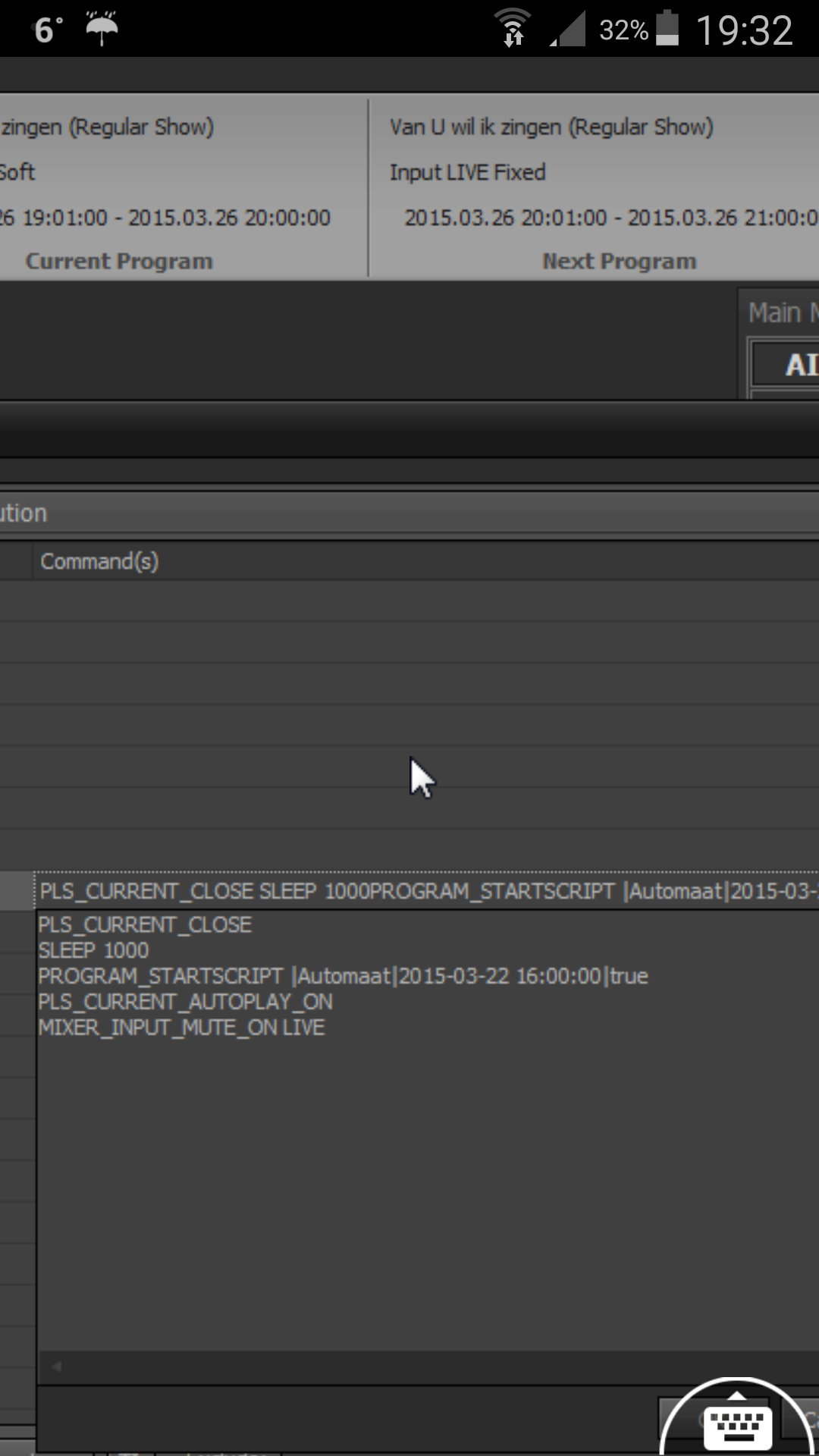

Hi Bernd.
We have a silence detection set up.
It always works for a while and then I need to change the date in the startprogram script line.
If I changed the date to a more recent date is works fine again.
but that is not all, lately forwarding a program is taking a lot of time.
When the silence detection is kicking in it is generating a new playlist and it says: forwarding program.
Normally it should take a few seconds to add some songs and starts playing.
Lately it is not loading any songs more.
When I tested the command line:
PROGRAM_STARTSCRIPT |Automaat|2015-03-22 16:00:00|true
it says the command line is 'ok', it opens a playlist but adds no songs to it.
It says please wait, program forwarded. For about 30 till 60 seconds! And then it adds some tracks.
Before it was taking a few seconds to do that!
What is the best way to create a silence detection?
We want to open a new playlist anf execute a script.
Why do we need to enter a date for that script line?
Greetz Jesper

I was using this line before: PROGRAM_STARTSCRIPT |Automaat|2015-03-22 16:00:00|true
NOTICE I'm using a date from the past 2015-03-22 and that is what you said a script that started late.
But when I use this command line: PROGRAM_STARTSCRIPT |Automaat|2015-12-31 16:00:00|true
I used 2015-12-31 as a date. A date in the future and I tested the command line.
Result: It was working smooth and was adding tracks directly.
HOWEVER: Now it is loading tracks quickly and good it won't start!? The autoplay is on and even if I manually toggle it on it ain't starting the playlist because the start date now is in the future and it waits till that date/time, right?
So my question: why do you need to enter a date in that command line? Because you never know when a silence detection kicks in, right?
Only thing it needs to do is open a new playlist and add some tracks from a script that is not marked with a date/time.
Something like this: PROGRAM_STARTSCRIPT |scriptname|duration|
