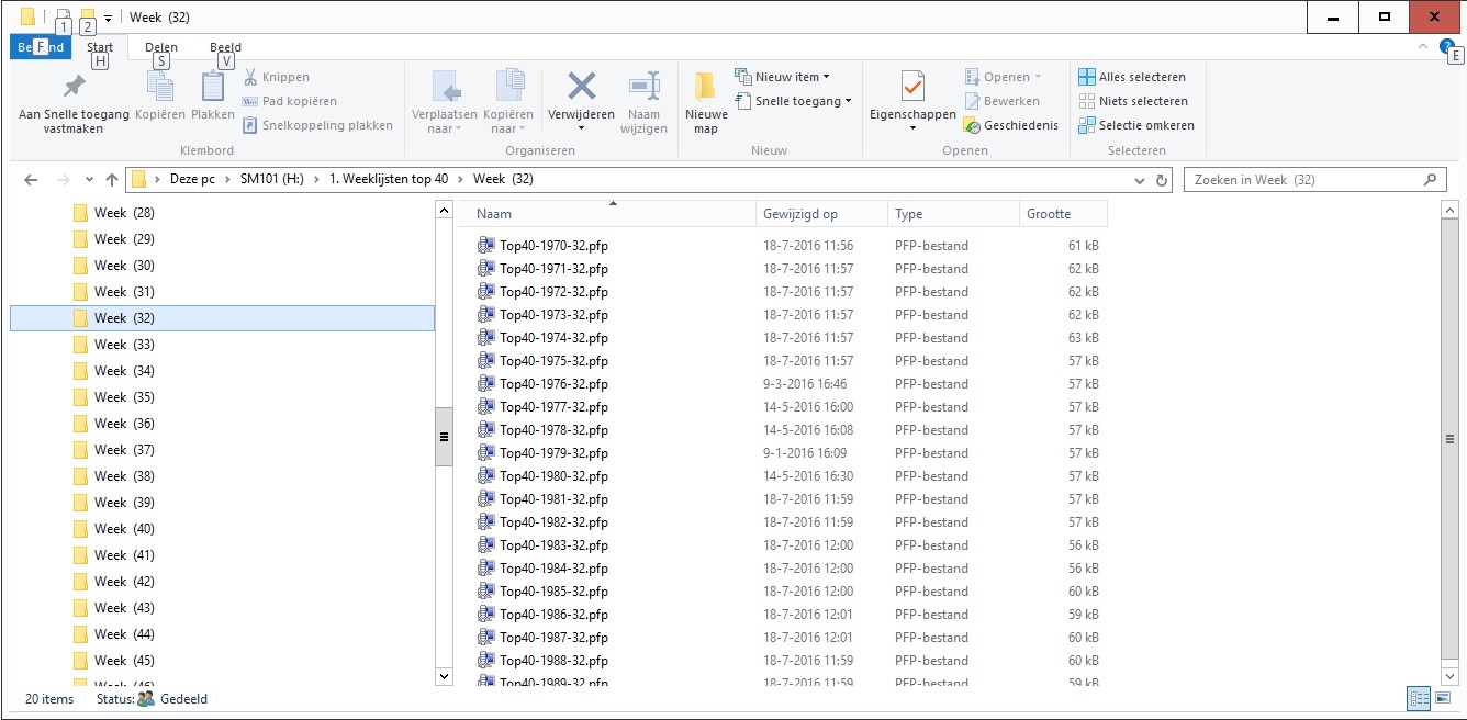

As there are 52 weeks in a year, have 52 maps with 52 PFP lists with 40 songs in every list ( the then number 1 till number 40).
Now, the script plays songs from several PFP lists.
What i need is that PF selects 1 list, plays all 40 songs and than starts with the regular schedule automaticly.
Question 2.
When i get this working, the script needs to select only the lists from week 31, in week 32 it selects only PFP list from folder week 32 and so on.
How to do this ( for me is is a serious quest).
PFP lists.jpg (204.14 KiB) Viewed 17208 times
Thxs Will

The script must do the following.Everyday PF have any Top40 list of the directory week # 32 where they get in it, see picture above.
Then plays PF 2 tables per day, 14 per week. That is all in week # 32.
In week # 33 PF does the same but loads all lists from the folder in week # 33.
Each list will be played in full, then PF continue regular programming. From now the tables will be played all over the year ( which means 52 week pro year).
