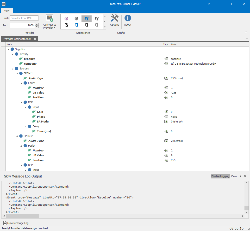

I am happy to announce the availability of a free Ember+ Viewer tool which you might find handy - feel free to use it, if you own any Ember+ equipment:
http://www.proppfrexx.radio42.com/downl ... mberViewer
