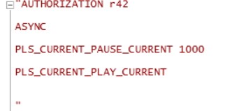

We put
1Знімок екрана 2023-04-11 160429.jpg (11.24 KiB) Viewed 7298 times
and it just switches between A to B track
may be we have some problem with playlist?
then we run command on play/pause
3Знімок екрана 2023-04-11 160736.jpg (9.1 KiB) Viewed 7298 times
with command ASYNC at the beginning and nothing is happening.
then we are running the script as you told without ASYNC
it just changes the track but if we run
everything plays OK
The problem is that nothing happens at all with ASYNC, and if without it, then just the tracks changes, the file with alert does not play at all :(
Re: Automatic air alert
Posted: 11 Apr 2023 18:39
No quotes (“) at all.
No empty lines.
When using internally commands with events, the AUTHORIZATION line is not needed and not supported.
The ASYNC command must be the first line.
