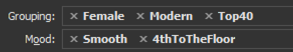

Here is an example:
Separate the entries by eg. semicolon to enter multiple values:

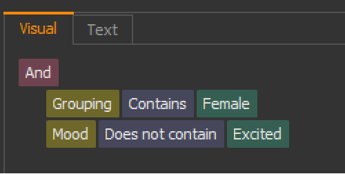

And the use a Filter with the contains comparison:
