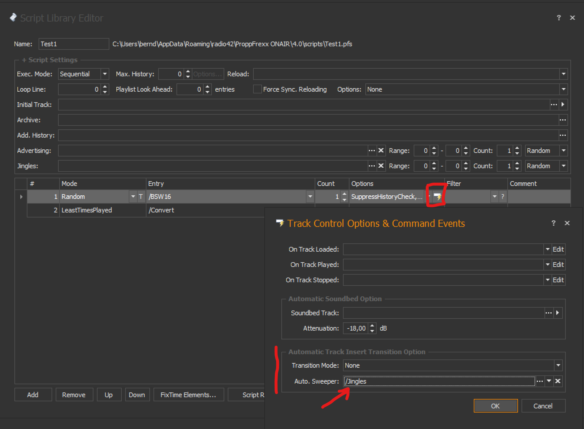

Posts: 9138
Re: add jingle on start of track automaticly
See the attached picture:

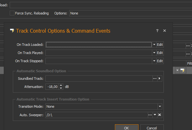

kevkev2001
Posts: 40
Joined: 30 Jul 2021 21:01
Post by kevkev2001 »
i dont see EndsWithRampOfNextTrack on the options tab
Posts: 9138
Read the tool tip.
That option is applied automatically.
You just leave the settings as in the screenshot. That’s it.

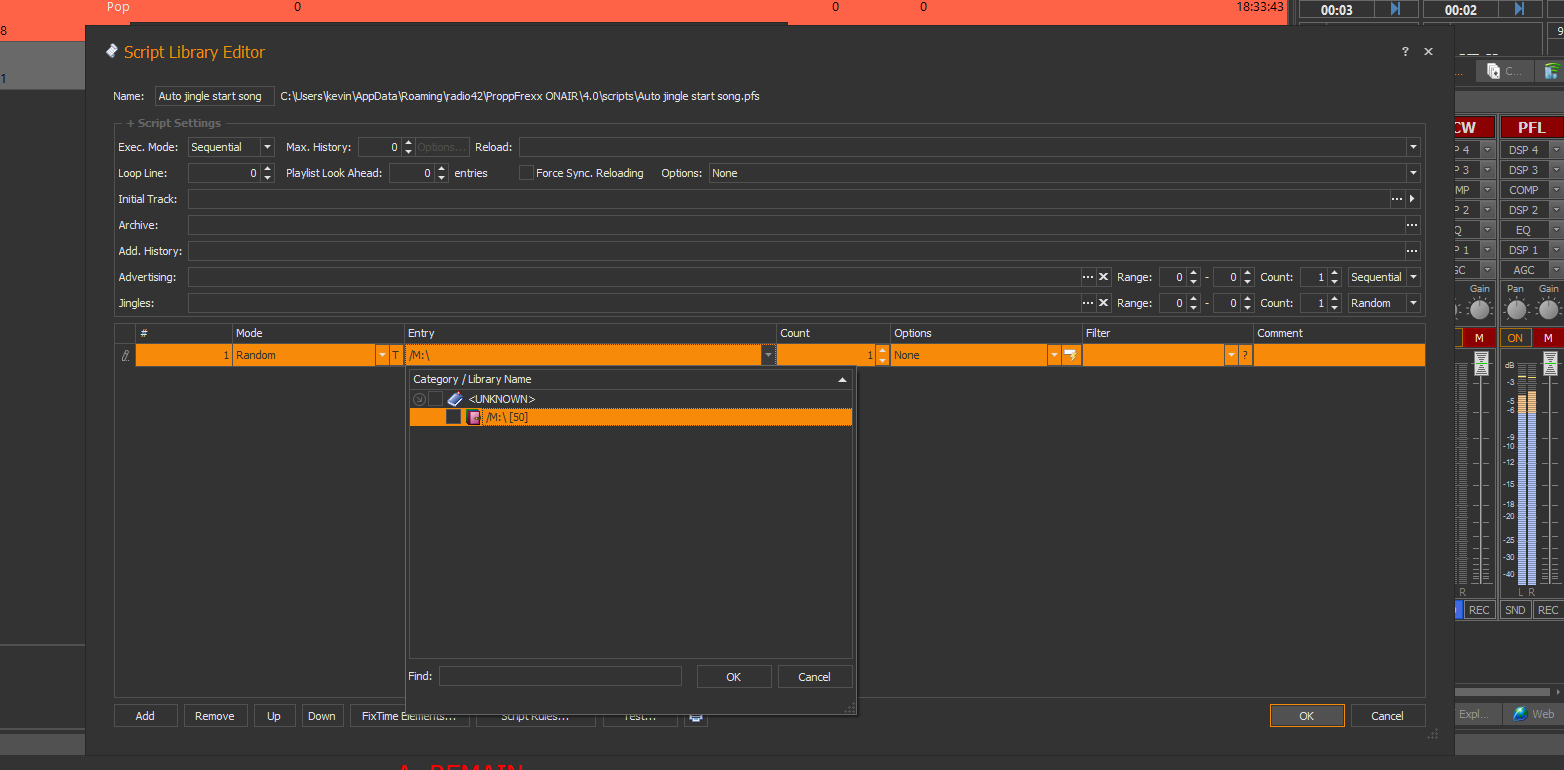

kevkev2001
Posts: 40
this is what i got when i use the ramp button noting starts in on auto play jingle
Posts: 9138
What Ramp button? If you mean the Ramp button in the DJ Player? This button defined the Ramp position of the track loaded to the DJ Player when in cue mode (at the current track position) - it does NOT trigger any sweeper.
You need to run the script and let it play to 'listen' to the auto sweeper... you do not trigger it manually...
