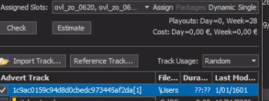

Is it possible to use a URL in the ad scheduler? One of the commercials is hosted on an external server.

Campaign
Reference Track..
URL: https://dashboard......da.mp3

It doesn’t work properly. Sometimes it works once, and then it doesn’t. The new version is not being played

You have also send me an email, in which you explained, that the issue is, that the URL first plays fine.
But when the content of the file is updated on the server (your dashboard), that ProppFrexx still plays the old (previous) version.
And yes, this is correct, as for URL streams, ProppFrexx (even if you just add a reference) downloads the file locally (url streams can not be used as live streams for adverts). I.e. ProppFrexx Advertising wouldn't play remote URL streams as adverts.
As a solution, you should build a local cache of your advert tracks and download them every day and then play from these local files.
This is even much more reliable and stable than streaming URLs. I.e. assume you have to play 10 individual URLs in an advert block. The timing would indeed not really good, as you would have noticable beaks between your different URLs.
