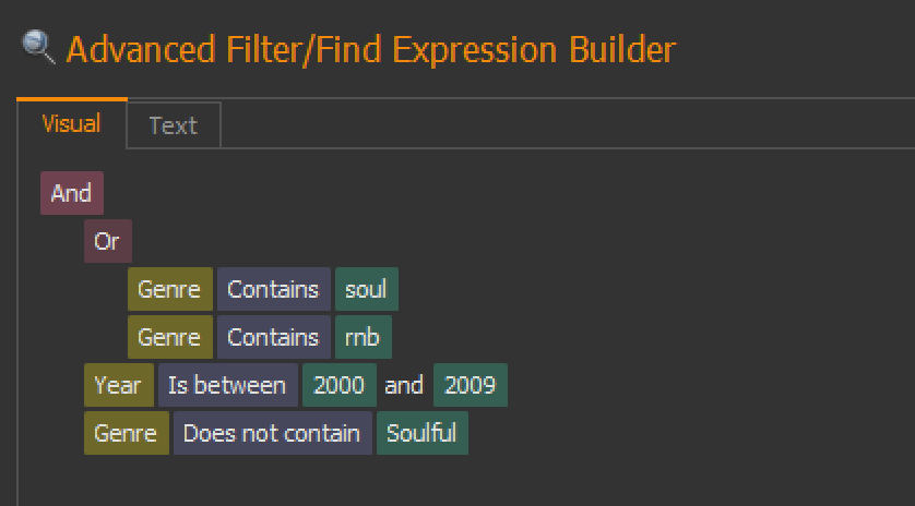

Is this what you want?
Note, that you can also use the 'Text' view to simply add logical brackets (which defines a group).
In this example, the 'Genre' can contain either 'soul' OR 'rnb'; plus (and) the 'Year' must be between 2000 and 2009; and the 'Genre' should not contain 'soulful'...
Text:
(Contains([Genre], 'soul') Or Contains([Genre], 'rnb')) And [Year] Between('2000', '2009') And Not Contains([Genre], 'Soulful')
