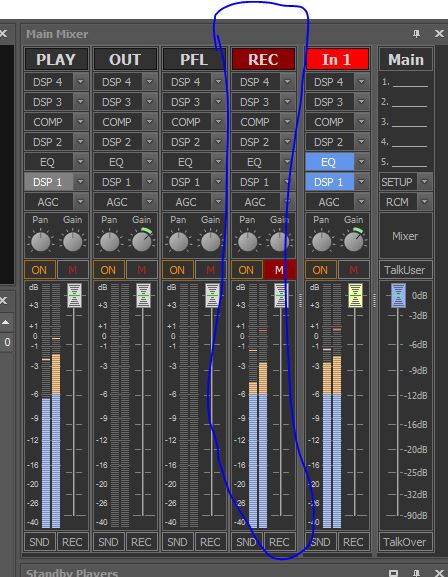

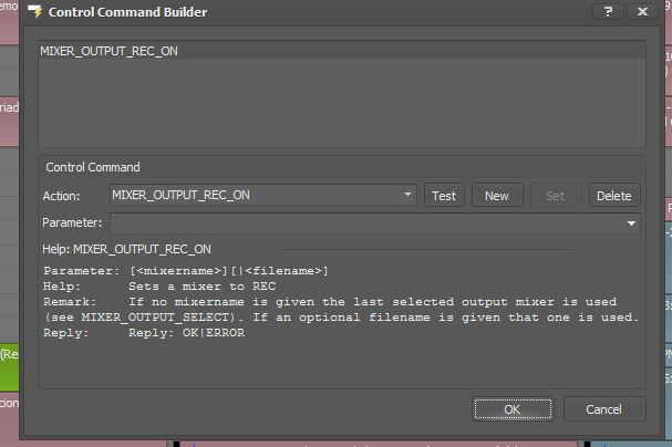

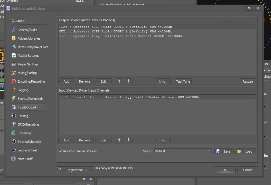

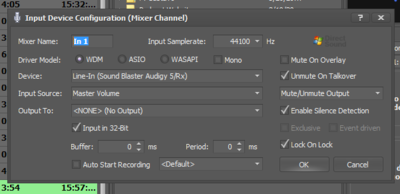

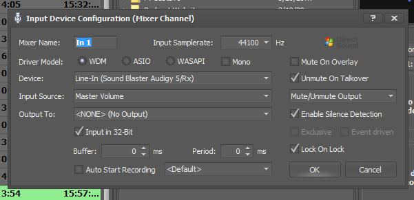

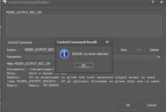

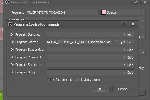

Hello, I still have this problem, I'm trying to set automatic recording on a specific program using a command option but i have an error
I used this code script:
MIXER_OUTPUT_REC_ON
OUT|showname.mp3
and you told me i need specify the output to record and name ??? please i attached photos for my imput can you help to make sure according my photos what i need to do, I really thanks your help

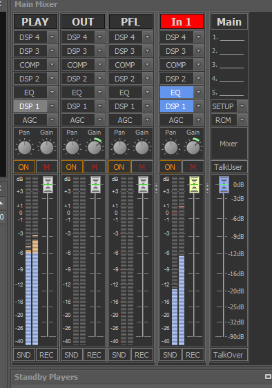

Enriquetech
Posts: 20
Joined: 01 Feb 2017 22:27
Re: Unwanted broadcast record
Post by Enriquetech »
Other pictures about my stting
Posts: 9141
There seems to be a space missing in the above command, between the control command MIXER_OUTPUT_REC_ON and the subsequent parameters.
From the mixer channel it also looks like you may also want to use the PLAY mixer channel?
But if you want to have a combined signal of your Mic input and the PLAY channel you would do a bit more. Unfortunately I don’t know your exact setup.
I do see, that you are using 3 mixer output channels and have one mixer input channel, but I don’t know how they are connected. Are you using an external mixer console?
If yes, maybe you also want to record the In 1 mixer channel instead of PLAY?
I also don’t know, if your default recording profile is set to encode in MP3?
But first correct your command and add the space.

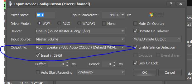

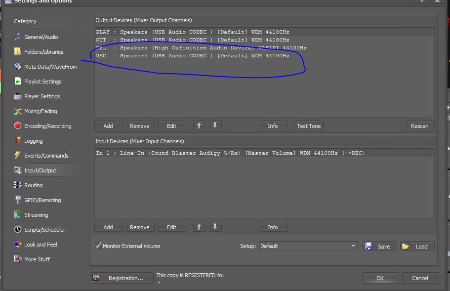

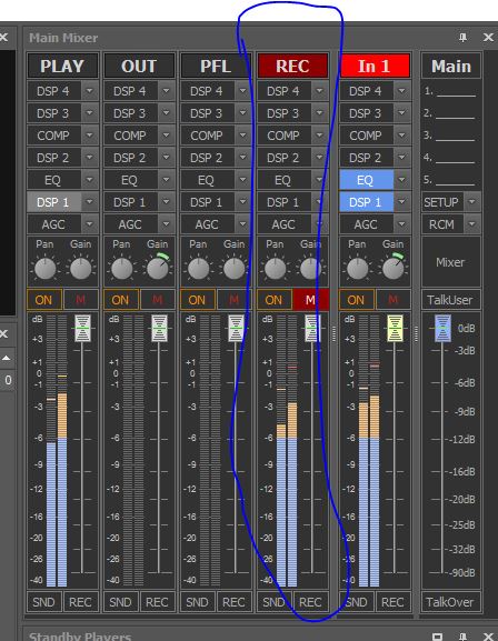

Enriquetech
Posts: 20
Ok i Undertand, Now I create a new Output that i want use as a red, if you see the pictures you will see the i am sending the signal from my micro In to my mixer output REC do you thinks is posible to set up now??
