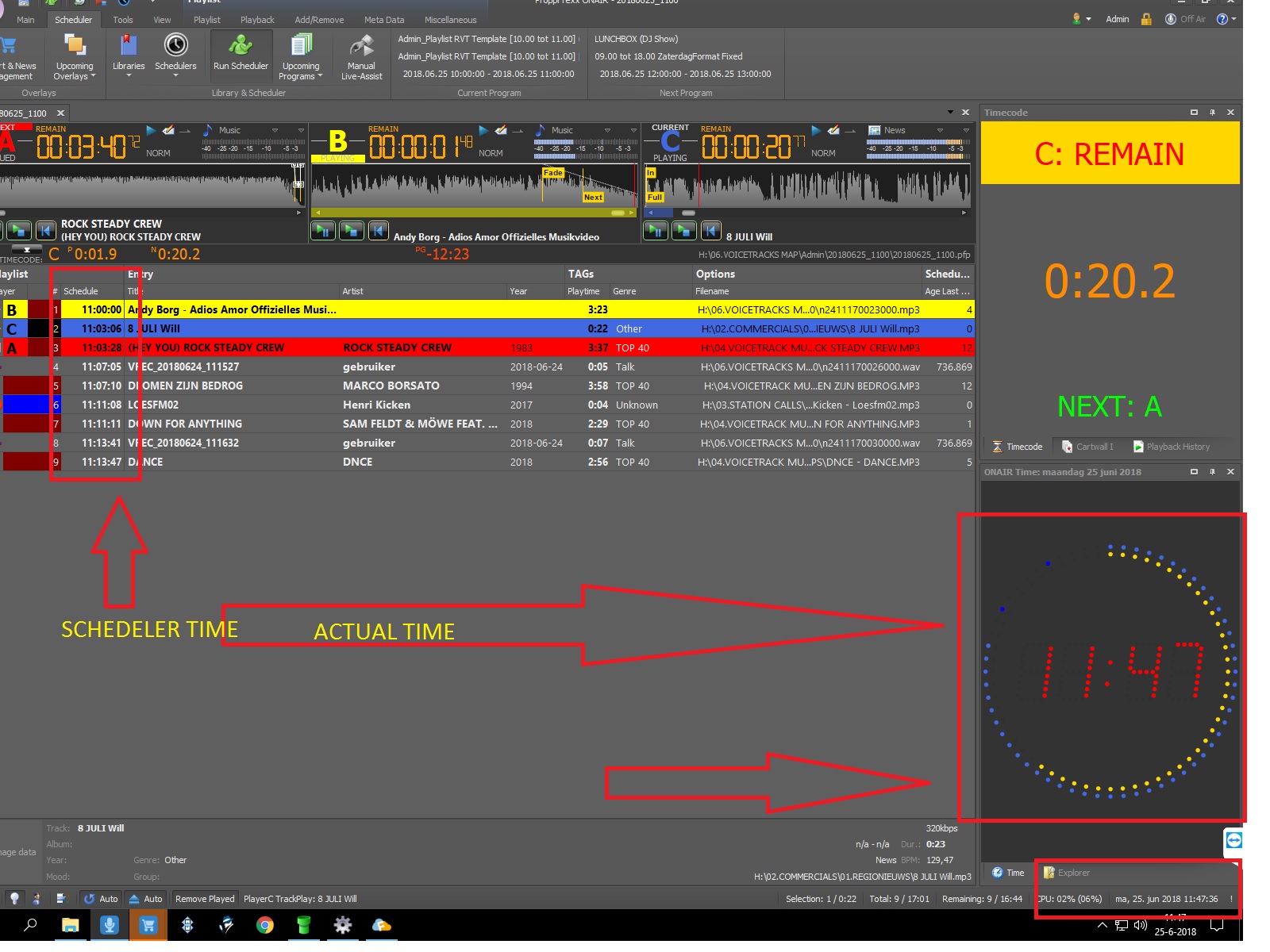

Take a look at this.
The actual time is 11.47. The scheduler time however is not running and shows a different time. I guess this is weird?

Regarding your previous picture: Can you please check what you have been set in the Playlist ribbon tab underneath the 'Playlist Backtiming' button?!
Is there maybe an explicit time being set and not the default option 'Start with current Time' enabled?
