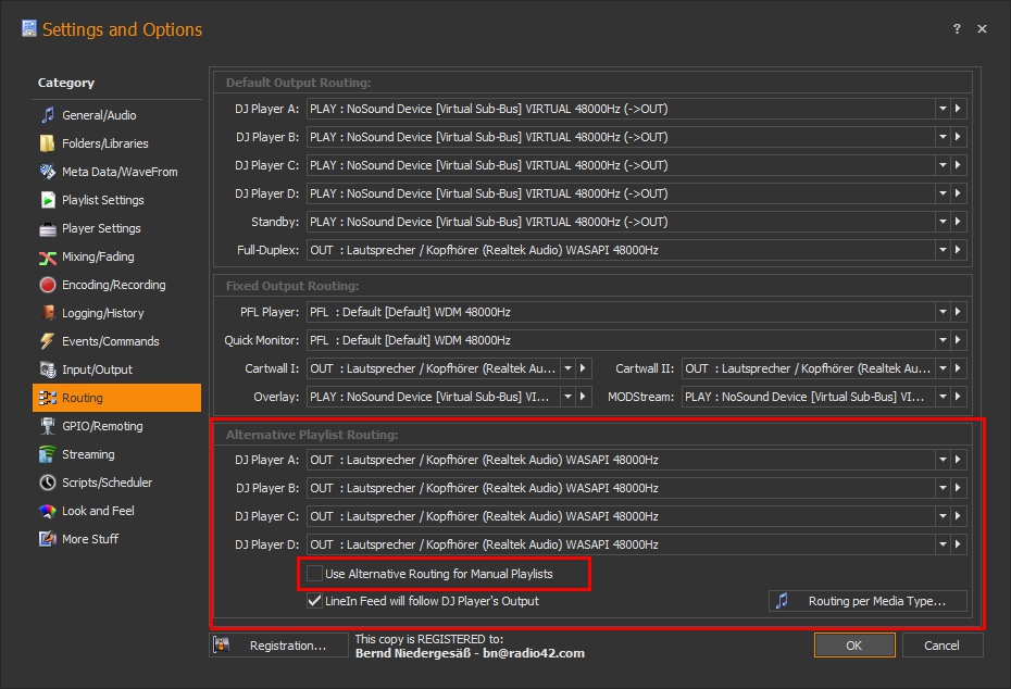

To define the 'Alternative Routing' go to the general settings, section 'Routing': The Alternative Routing is typically used for any Manual Operations! Ie. define the 'Default Routing' of your DJ Players, so that work fine in Automation Mode!
I suggest to only use a single output (the same) for all DJ Players. This means, that in automation mode you only need to make sure, that this fader is up on your console.
The 'Alternative Routing' is than used for all manual operations (note, that you can toggle this mode automatic/manual) in the main ribbon tab by one click (see the 'Manual Live Assist' button). Ie. in manual mode you might want to assign a different mixer out channels (fader) to each DJ Player individually.
In order to swap the routing based on the 'Manual Live Assist' button state, you can define the mode in the general settings, section 'More Stuff' - click the 'Manual Operation...' button: Summay:
The Alternative routing allows you to define different routing of the DJ Players when in Manual Live-Assist mode or in Automation-Mode.
Ie. Multi-Output-Channel usage (multi-faders) or Single-Output (one fader).
