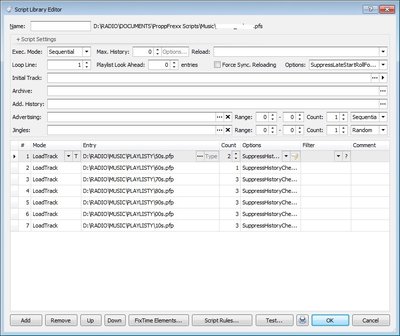

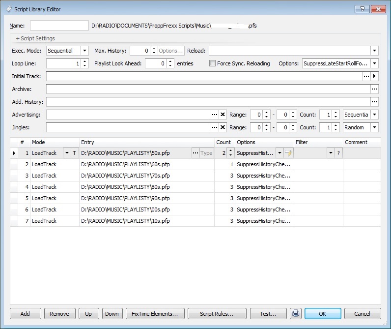

Can I somehow define a script which will take 2-3 songs from different playlists, i.e. I have defined different pfp playlists and I need a script that will choose some number of (random/at least played) songs from these playlists and play them sequentially.
Attached is printscreen what I have defined so far.

You need to define the resp. playlists as media libraries.
Then you can select from them.
See here for details:
viewtopic.php?f=9&t=11
and here:
viewtopic.php?f=9&t=10
The LoadTrack mode would load all tracks of the given playlist as one continuous single stream.
The LoadPLaylist mode would load all tracks of the playlist as individual items one by one as given in the playlist.
The LoadFolder might be an option you could use, as this would allow you to randomly pick tracks from a given folder - but yours are actually plalyists. As such, you must first define them as a media lib, and them you can use the for example the Random mode.
