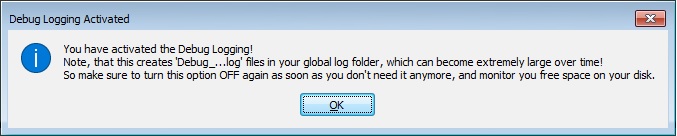

Hi Bernd.
Even though I deactivated debug logging each time I open settings I get message debug logging is activated and I have to untick this option again. How can I set debug logging is turned off always?
Thank you.

The Debug Log is ONLY activated manually: either thru the general settings or at startup via the "-debug" command-line parameter when invoking "ProppFrexx ONAIR.exe"; e.g. if invoke it like this: "ProppFrexx ONAIR.exe -debug"
So please check your command-line parameters.
Else, if you are using the ProppFrexx Watcher tray application, this one might also remember the last command-line options used; i.e. if you initially used it, it might still remember it once started. In that close the Watcher completely and start ProppFrexx without any command-line parameters.

None of these options is my case. I do not use PF Watcher and I start PF only with icon created by installation itself, i.e. "C:\Program Files\radio42\ProppFrexx ONAIR\ProppFrexx ONAIR.exe". But now I see where could be the problem, my steps bellow:
1. I start PF
2. When I open settings debug logging is deactivated
3. I open script libraries
4. I do a test of one script
5. When I open settings again I get the message debug logging is activated

Yes, during testing a script, the debug logging will be enabled and when finished, it will be disabled again.
(this to capture all test results)
That would sound, as if it wouldn't be deactivated properly in your case - I'll take a look what this might be.
