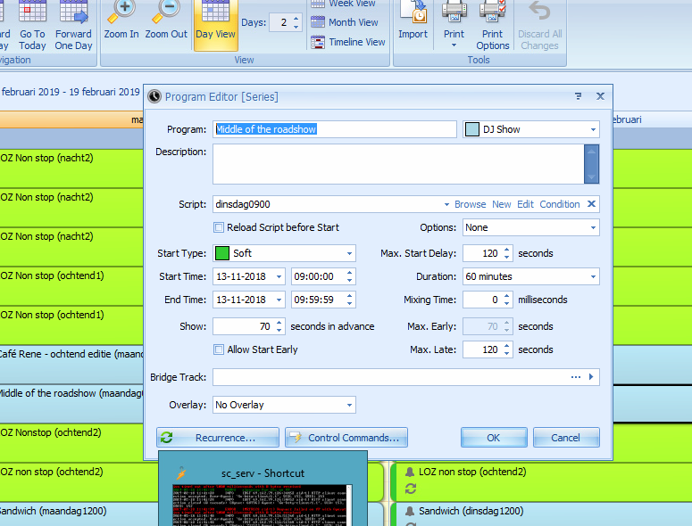

there is a difference between a regular scheduler item as wel a overlay scheduler.

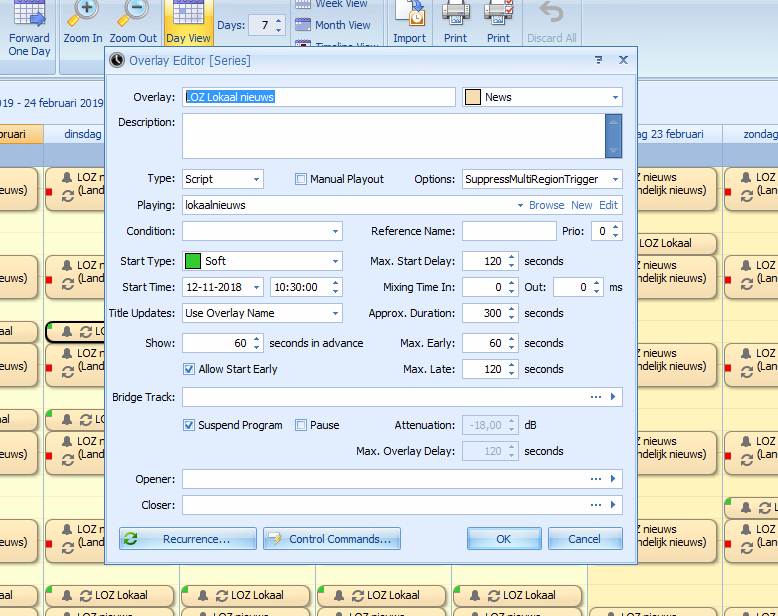

In a overlay scheduler you have to option to choose the option Title Updates... but not available for a regular program.

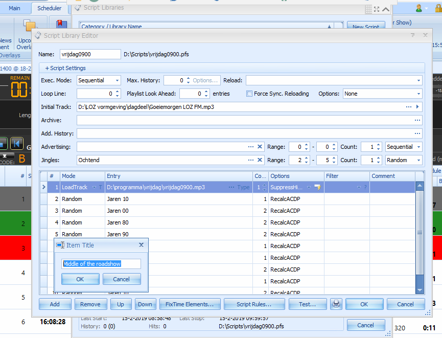

In a regular program i use a script where i have used the Title option which is available in the script
script is based on:
When i use this option the title is not display in shoutcast. He remains the initial file which i have choose.

Option Title updates (use overlay name)

The Overlay Scheduler runs on top of the Program Scheduler, that's why you have these additional options.

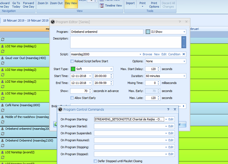

When i use your commands in the scheduler, i notice that shoutcast is already reading this in advance..
So the the program starts at 20.00 but is already shown before 20.00 hr.
Any suggestion how this could be?

Scheduler
Scheduler

You should use the 'On Program Started' event (as written in my posts above).
Note, that the 'On Program Starting' event is raised when the program shows in advance.

Else you can set the 'Song Title' with the script-line which loads the track, ie. the 'LoadTrack' script-line (by clicking on the small 'T' button).
When a dedicated song title for a script-line is specified (by using the 'T' button), then the meta data of that track is not used.

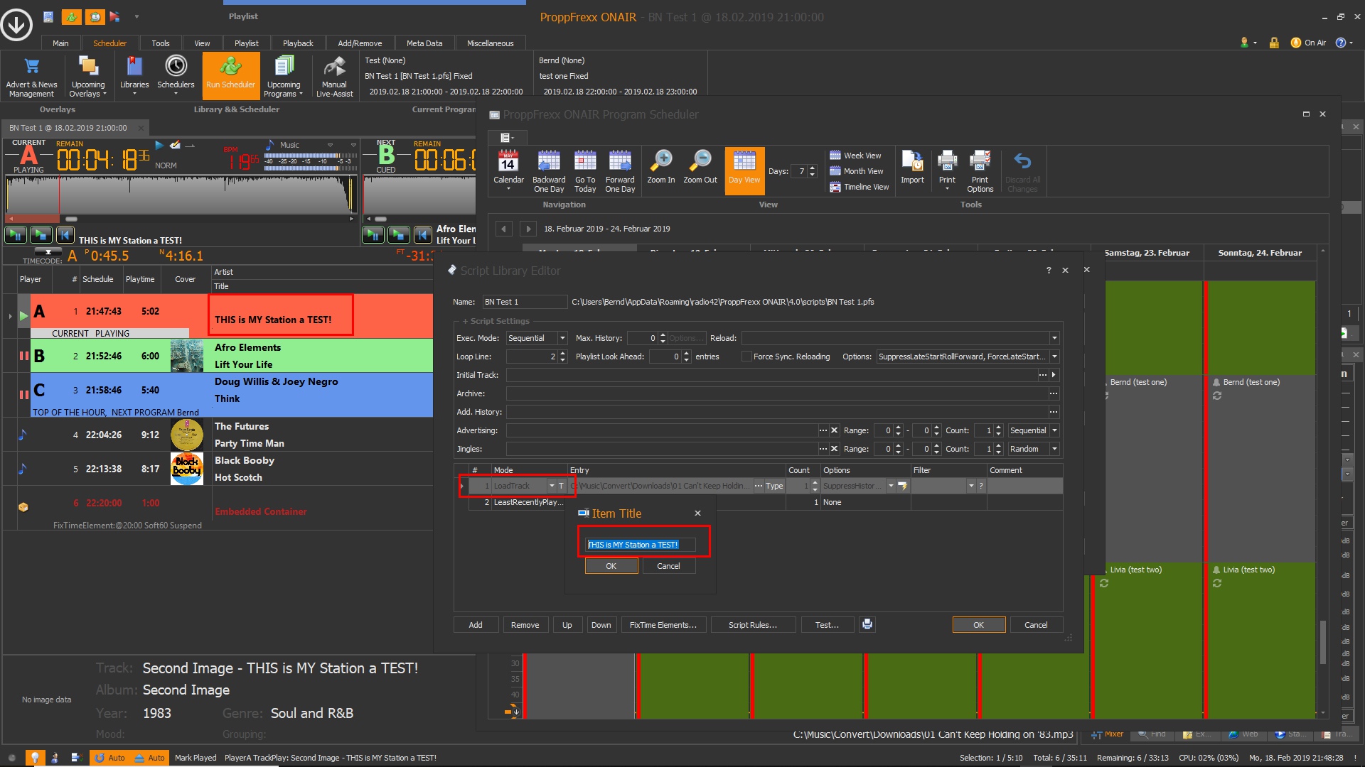

Here is a regular example (note, that my streaming server, song title format in the streaming server config is ${trackname})!
In this example I have used a 'LoadTrack' script-line, which loads a sample audio track, which has some meta data set this track (actually this is a track from 'Second Image' called 'Can't Keep Holding On'...but this could also be your 58 minute long pre-recorded show track!
I have clicked on the small 'T' button in that script-line to specify an alternative song title: "THIS is MY Station a TEST!"

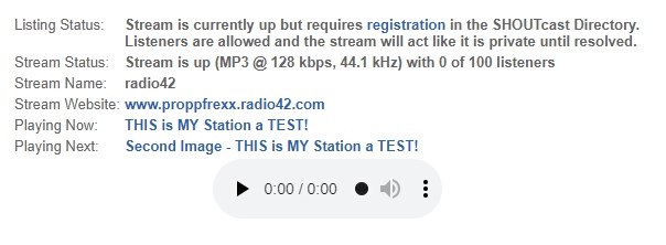

First the Shoutcast v2 output as displayed:
And here how it looks in ProppFrex, when I start the Program via the Scheduler:
As you can see, all works as expected!
