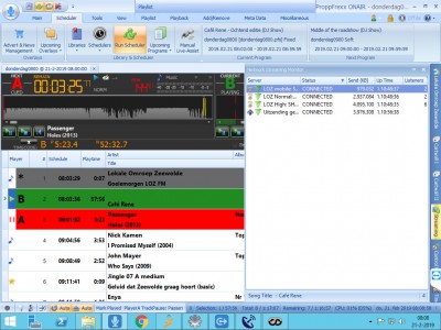

result
result

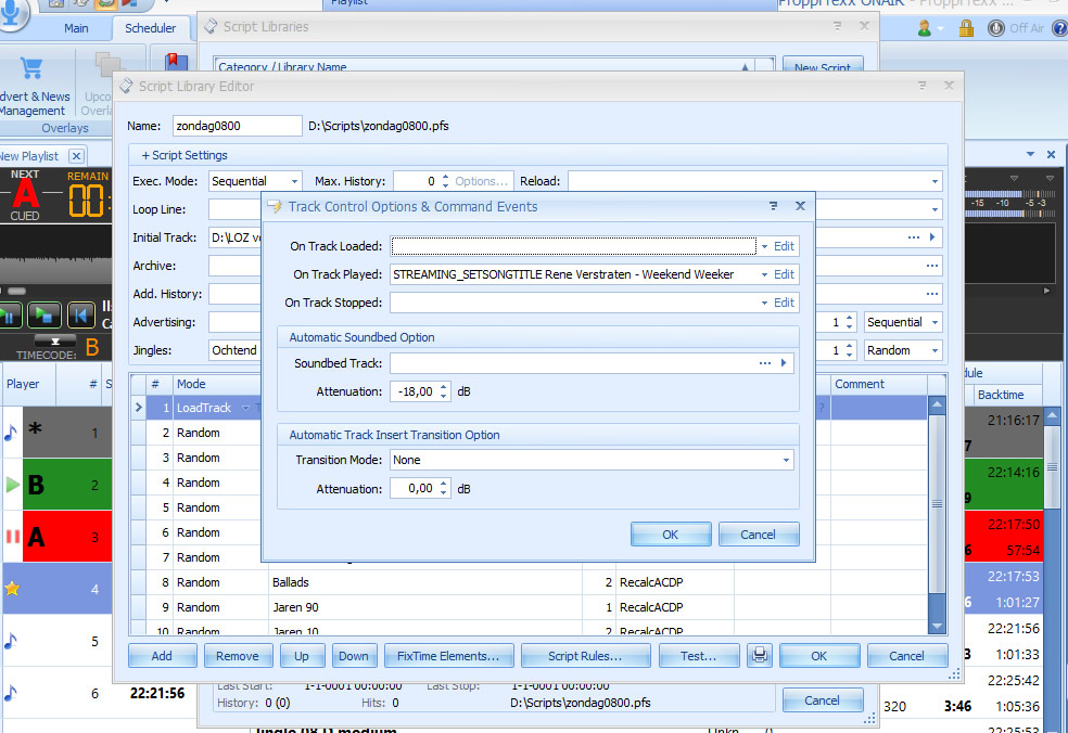

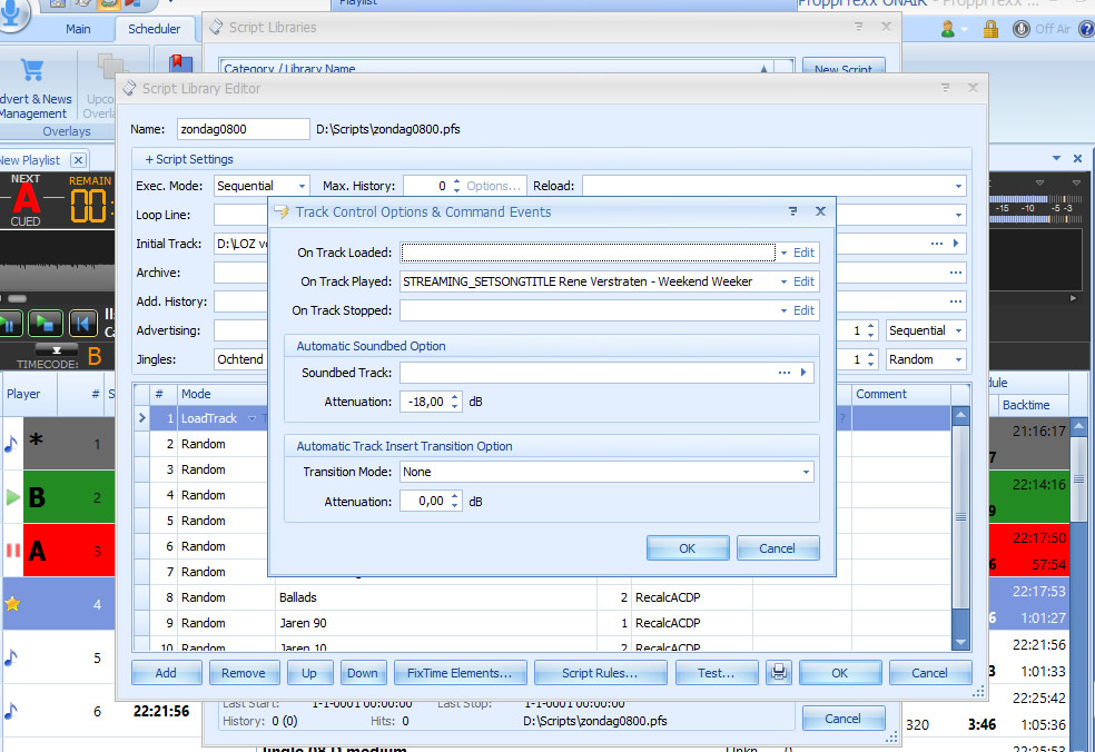

We use the command line
But today I will try the t-button ..

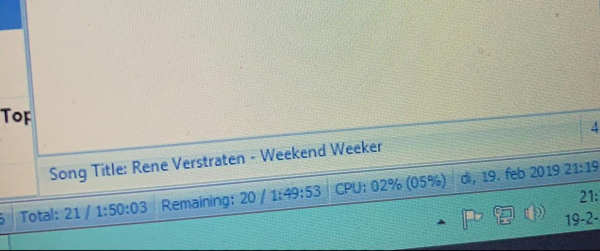

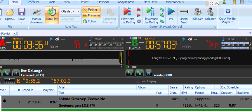

As prommissed an update from our test we have run.
We have tried the T botton, but without succes.

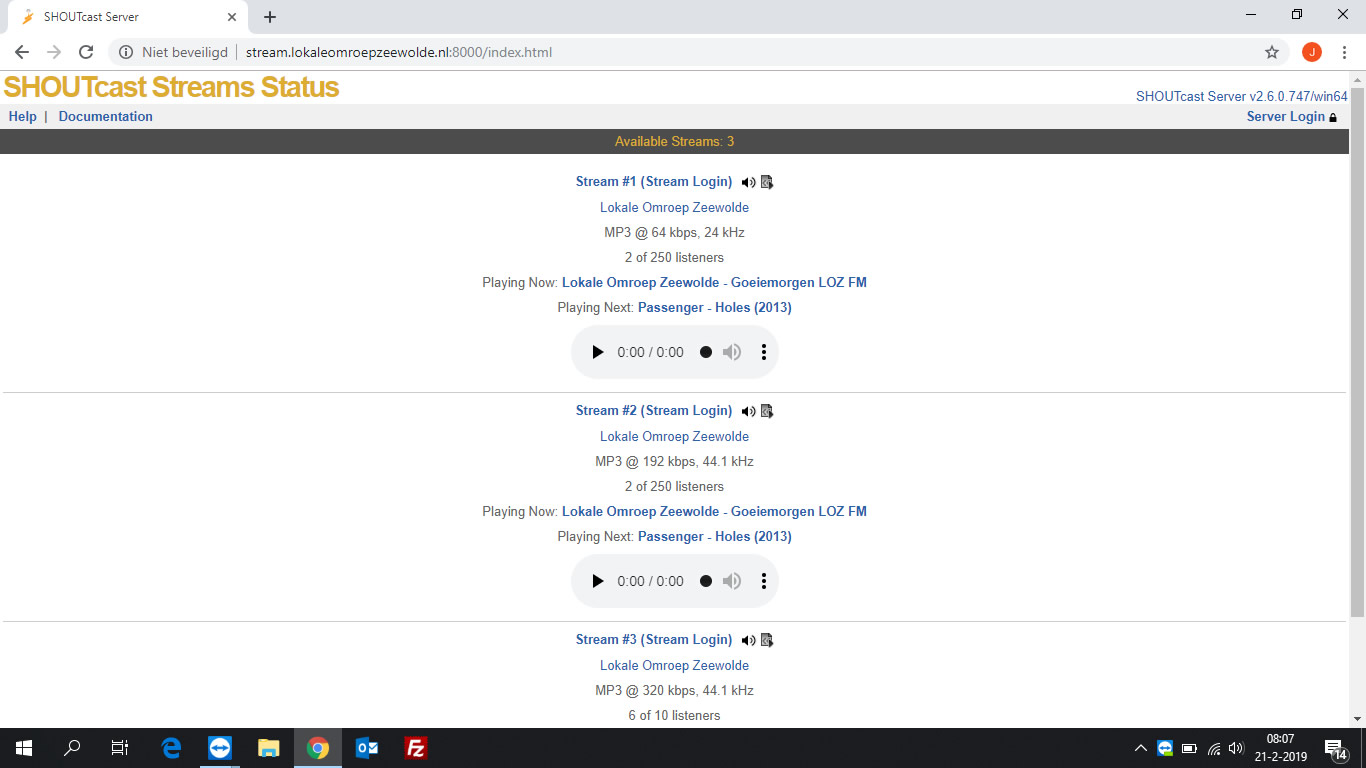

The program is correctly displayd in the player, but shoutcast can not handle it, and remains at the initial track which is selected in the script.. So for us i assume that the best thing we can do is to use the command line..
PF with program name
shoutcast display initial track from script (using t-option)

I am sorry, but here it works, as you can see from my pictures above.
Maybe you have excluded that related track's music entry type from the song title updates.
