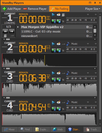

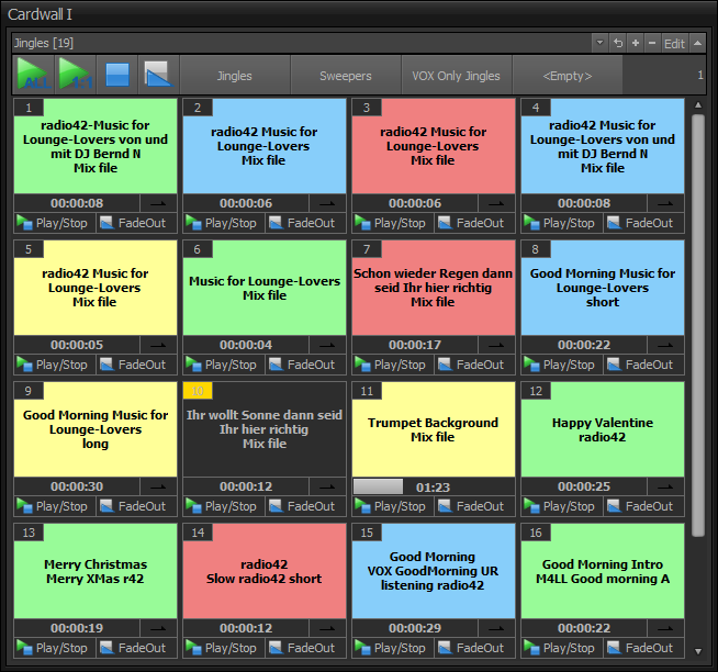

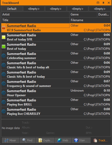

ProppFrexx comes with 2 independent cartwalls:
And also an additional list of so called Standby Players:
As well as a Trackboard:
So I am not sure, what exactly you are missing here?

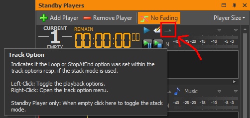

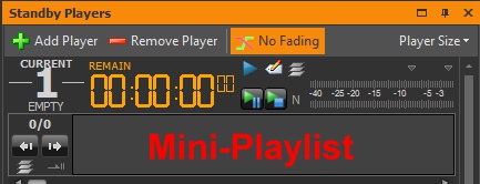

Posts: 9138
Re: Jingleplayers like Omniplayer, Dalet and Aeronstudio
The Standby-Player's Player-Size must NOT be "Small (No WaveForm)" or "Medium (No WaveForm)", e.g. it must be "Small" or "Medium" or "Full".
You then click on this icon as shown above.
And get the player into stack mode:
