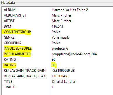

Now i recently discovered a problem that PF does not read the Grouping tags in my mp3 files.

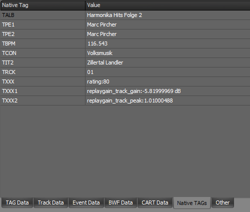

In the PF TAG Editor i don't see the Grouping tag in my mp3 files within the Native TAGs tab.

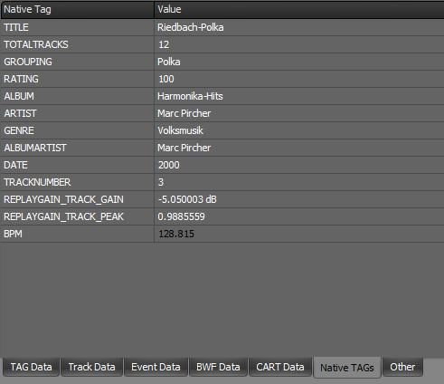

For all of my FLAC files, i also tagged with mp3tag, it works like a charm. The tag is also shown in the Native TAGs tab.
I see differences in the Native Tag descriptions for FLAC and MP3 files. In MP3 i see the Native Tag discription as abbreviations.
Can there be a translate problem for the Grouping tag?
When i use the grouping tag inside the PF TAG Editor i see (besides some extra unusefull created tags :( ) a new created "Contentgroup" in mp3tag, even when i first delete the "Grouping" tag in mp3tag. However, i do not see the new tag in the Native TAGs tab, even after a rescan of my mp3 files in my folder based media library and restart of Proppfrexx. It seems like PF does not recognize the Grouping tag in mp3 files.

Some screenshots i made:
- 1st MP3 Native TAGs info
- 2nd FLAC Native TAGs info
- 3rd same MP3 but mp3tag info
Kind regards,
Henk

Leaves me with the question, why can't i also see the TIT1, TT1 information in the Native TAGs tab area when i use the Grouping tag within the PF TAG Editor?
I have used the save button so it should been saved to the mp3 file. When i perform a new (re)read of the saved tag, i would expect at least to see the new created Grouping tag in the Native TAGs overview. But it isn't.
So it seems PF is not storing / reading the Grouping Tag in the TIT1 frame at a right way either or not all tags are shown as Native TAGs.
When i delete the edited and saved mp3 file from the library and perform a rescan, the Gouping tag (created within PF TAG Editor!) is still missing in either the TAG Editor as in Native TAGs tab...A search with filtering at the genre and grouping tags gives no results so it won't work in my scripts also as i discovered lately.
As far as i can see and could test for now it seems like some (not all) changes like i.e. Grouping made in the PF TAG Editor will be stored in the media file as Contentgroup (according to mp3tag) but not (re)read as own stored tag :D
This also applies for the (by Proppfrexx itself created) BPM tag. I see the BPM tag in mp3tag with the right tag name and value as stated by PF in the Track Data tab. However, I can't see this native tag in de Native TAGs overview. But in contradiction to the Grouping tag i can filter at BPM and there are results shown in the search field. So i guess this tag is not a so called native tag according to PF?
Very confusing...while mp3tag and PF both does a perfect tag job with the OGG (FLAC) files.
Furthermore, i do see both replaygain_track_gain (TXXX1) and replay_gain_peak (TXXX2) , also created by PF in the Native TAGs tab overview.
I don't know how or what but something is wrong or broken. Can't say for now it is in PF or in all of my mp3 files. I'll do some further tests with other applications also.

MP3TAG make use of the GRP1 field for the Grouping tag with ID3v2.3 and TIT1 for the Contentgroup tag according their help page at https://help.mp3tag.de/main_tags.html
So it seems we have two ways to place extra information with our media whereby Grouping (GRP1) is the most common used for extra additional Genre info as far as i know and we have Contentgroup (TIT1), generally used for Grouping for MP4 / Work name for MP3. After some tests i can see that PF writes his "Grouping" tag as a "TIT1 Contentgroup" tag in ID3v2.3. Thus mp3tag reads the right stored tag by PF. And for FLAC, changes in the Grouping tag is neatly saved as "GRP1 Grouping" tag. PF writes the same Grouping content in the editor at multiple fields for different types of media? As far as i can see, this is not logical and really confusing.
