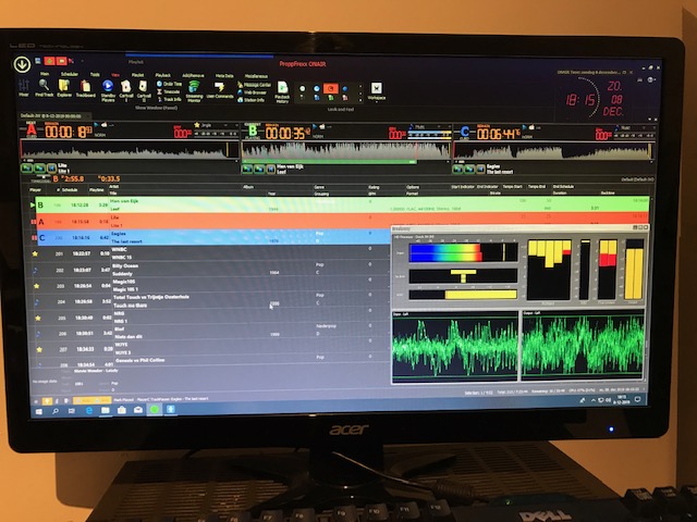

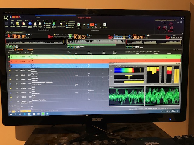

Re: Smooth track transition
Post by JWvanGulik »
Hi Bernd, I checked your solution and as far as I can tell this works. I was wondering however, if this does not influence the tempo settings for jingles as well. I will do some more testing, and let you know what is happening. By the way, I still don't fully understand what your solution means (streaming option, songupdatefilter???) but if it works, I'm happy. ;)
Happy holidays! -JW
