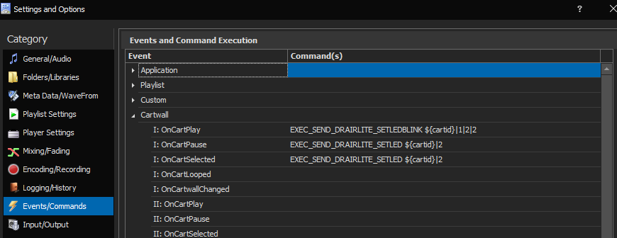

Maybe this screenprint helps

The issue is solved for the first row (CW1). But when I push a green button from row B (CW2) this stays green and the button left from it (row A CW1) turns red. Any idea what I've done wrong?
Kind regards Mark
Posts: 8951
Re: How to set light from the control buttons d&r airlite
No, as I/we don’t know your command mapping for the events you used.
And I/we also don’t know how you would like to map the buttons to the cartwalls.
Note, that the buttons of the Airlite are numbered.
Also note, that the cartwall carts are also numbered. Cartwall 1 and 2 are using the same cardIDs!
But these numbers are of course not matching the Airlite buttons.
So you probably need to apply some math to the cardIDs.
See the *INT[...] macro function for details (in the user manual appendix).
