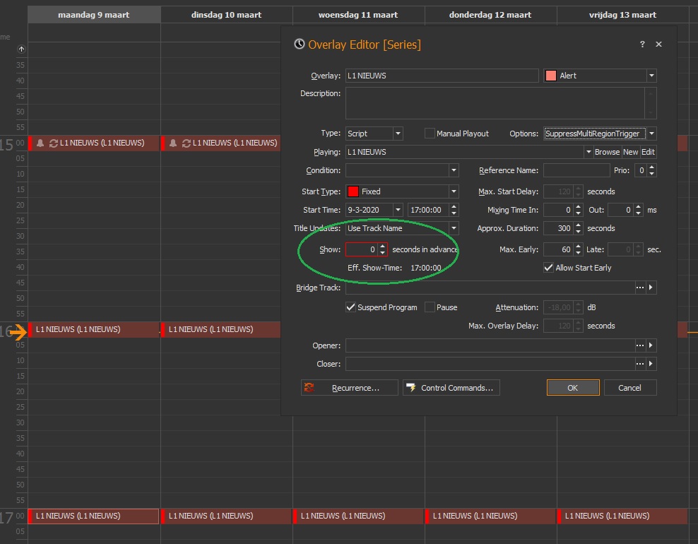

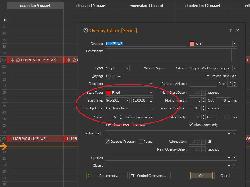

As you can see, this is what happens.
When i look into the same screen, one hour before i notice this.
What does that mean? It plays well at 15.00. At 16.00 it won't play because???
I've selceted the file from 15.00, dragged it it to 16.00 and click the right mouse button and select copy. But as i showed, something changed.
What can i don to fix this?
This will only play on specific days and times.

Well, first your mentioned times wouldn’t match the screenshots!
There is one entry with a start time of 15:00 and one with a start time of 17:00.
Once an entry was already executed or in case you copied one, its show in advance time is set to 0. Which means it will not be automatically triggered again and is disabled. Enabled entries are shown with a bell icon.
Click on the ‘?’ Icon at the very top right to get a detailed explanation of each field.
You should also note the difference between a series (recurring) entry and a single (occurrence) entry.
The first will repeat in the given recurring pattern (see the green recurring button), while the other one is executed just once.
The entries with the round circled arrow icon is a recurring entry (a series).
