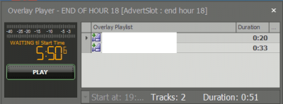

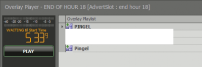

I configured the Multi region advert part of ProppFrexx.
I encounter 1 issue...
In the configuration of the advert manager, i have an opener and a closer.
On the main computer, this opener and closer is playing, but on the Slave computer NOT.
I tried first to configure the opener in the slots, no result. Now it is configured in the Overlay editor... still no opener and closer on the SLAVE overlayplayer.

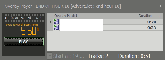

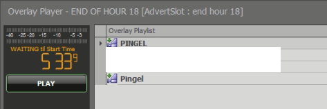

Attached 2 printscreens (fyi- the white fields are the customers)
Any advice how to get this solved?

Are these files accessible from the Slave computer?! Same path, drives available there as well etc.?
Are you using/referencing the same Advert Storage Path from the Slave PC?

Are these files accessible from the Slave computer?! Yes
Same path, drives available there as well etc.? Yes
Are you using/referencing the same Advert Storage Path from the Slave PC? Yes
Posts: 9141
Re: Multi-Region Advert/News
Then it sounds impossible.
You can turn on the Debug Logging on the Slave PC and send me the related Debug_...log file created to take a look at.
Plus post your screenshots of your related overlay entry configurations (where you defined the opener and closers) to look at them.
Or could it be, that you just edited the Overlay's Opener/Closer values and then immediately tested it?
I.e. could it be, that the new data wasn't loaded yet by the Slave instance?
If so, you might try to force loading the new Overlay Scheduler data by sending the OVERLAY_SCHEDULER_RELOAD control-command to the Slave - or Reload it manually on the Slave PC first.
