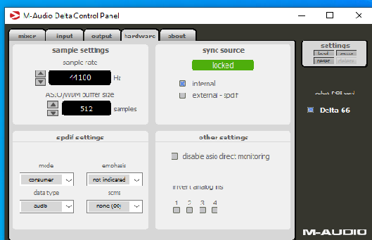

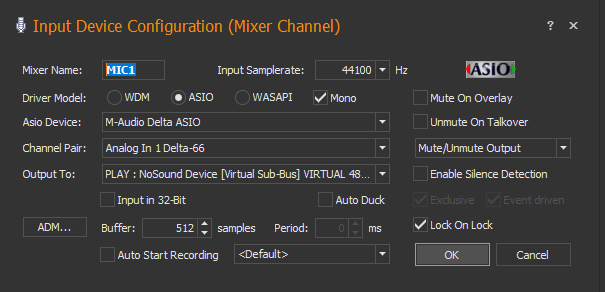

Nootje2+0
Posts: 22
Joined: 06 May 2020 16:18
Re: Mic installation.
Post by Nootje2+0 »
What am i doing wrong? I get a huge "echo" on my microfoon?
Asio4all already removed that didn't work either, now found this control panel from my sound card (M-audio Delta66)
Can you help me with this? do youn know what it is?
Thanks,
Are you getting an echo? Or do you still have a delay coming from the MIC?
If the latter:
- set the Buffer in the ProppFrexx mixer channel configuration back to 0 (so it only uses the drivers buffer)
- reduce the driver (M-Audio) buffer from 512 samples in steps (e.g. to 256, 128...)
You might also check (in the M-Audio panel) the 'disable asio direct monitoring' - maybe in that panel you already routed the signal to one of the output channels - see the input and output tabs... but that is an M-Audio config thing I am not too familiar with ...
