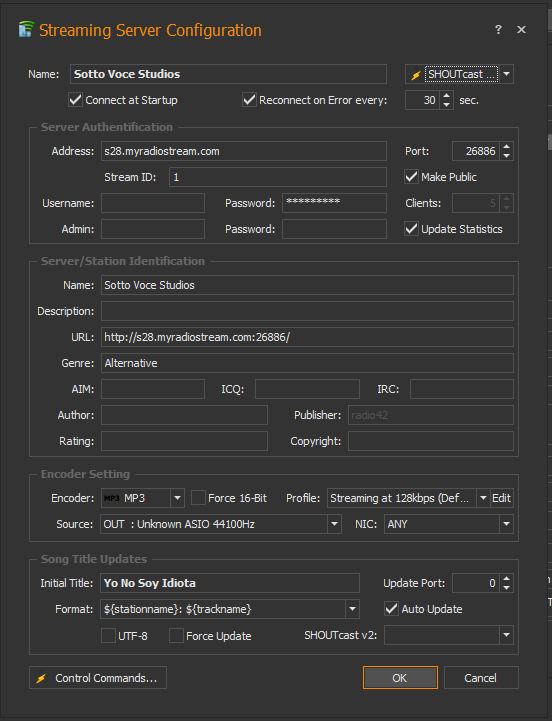

Thank you for your response. Enclosed please find an attachment of my server configuration.
The parameters are as follows:
Address / Host: s28.myradiostream.com
Stream Port: 26886
Streaming version: SHOUTcast v1
As I mentioned, I successfully connect to the server using winamp with shoutcast dsp using the same settings.
Kindly
Richard

Re: Cannot Connect and Activate Encoder
But I do ;-)
You need to leave the field 'Stream ID' empty! As otherwise the SHOUTcast v2 protocol is used.
Click on the '?' icon at the very top right to get further help for each option.

sottovocestudios
Posts: 3
Joined: 23 May 2020 02:29
Post by sottovocestudios »
Thank you very Much!!!!
