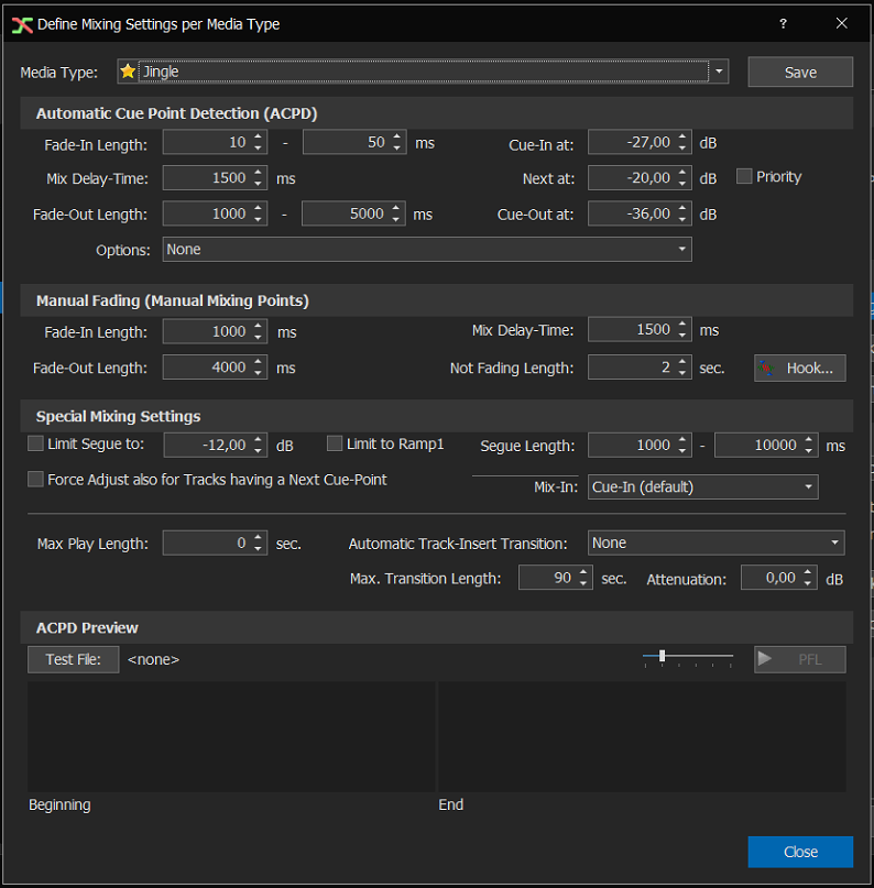

No. But this would also disable the possibility of what I explained above. There must also be another setting which was changed in the mixing Settings per Media Type (as said above). This is real root cause.
So look up the Media Type of those cartwall tracks and post a screenshot of the related settings.
franksiegers
Posts: 122
Joined: 15 Nov 2019 14:24
Re: Where are CuePoints stored?
Post by franksiegers »
I do not really understand what you mean. Here are the Mixing per Media Type settings for type Jingle. That's the type I've set in the cart wall library.
I suppose these are the default settings? I cannot remember having changed anything here. I did notice the Not fading length is 2 secs. Most tracks were just under 2 secs but I don't think that would cause the Next cue to be moved more to the beginning?
Anyway, I hope you can make anything of it.

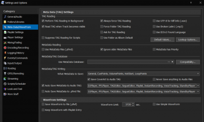

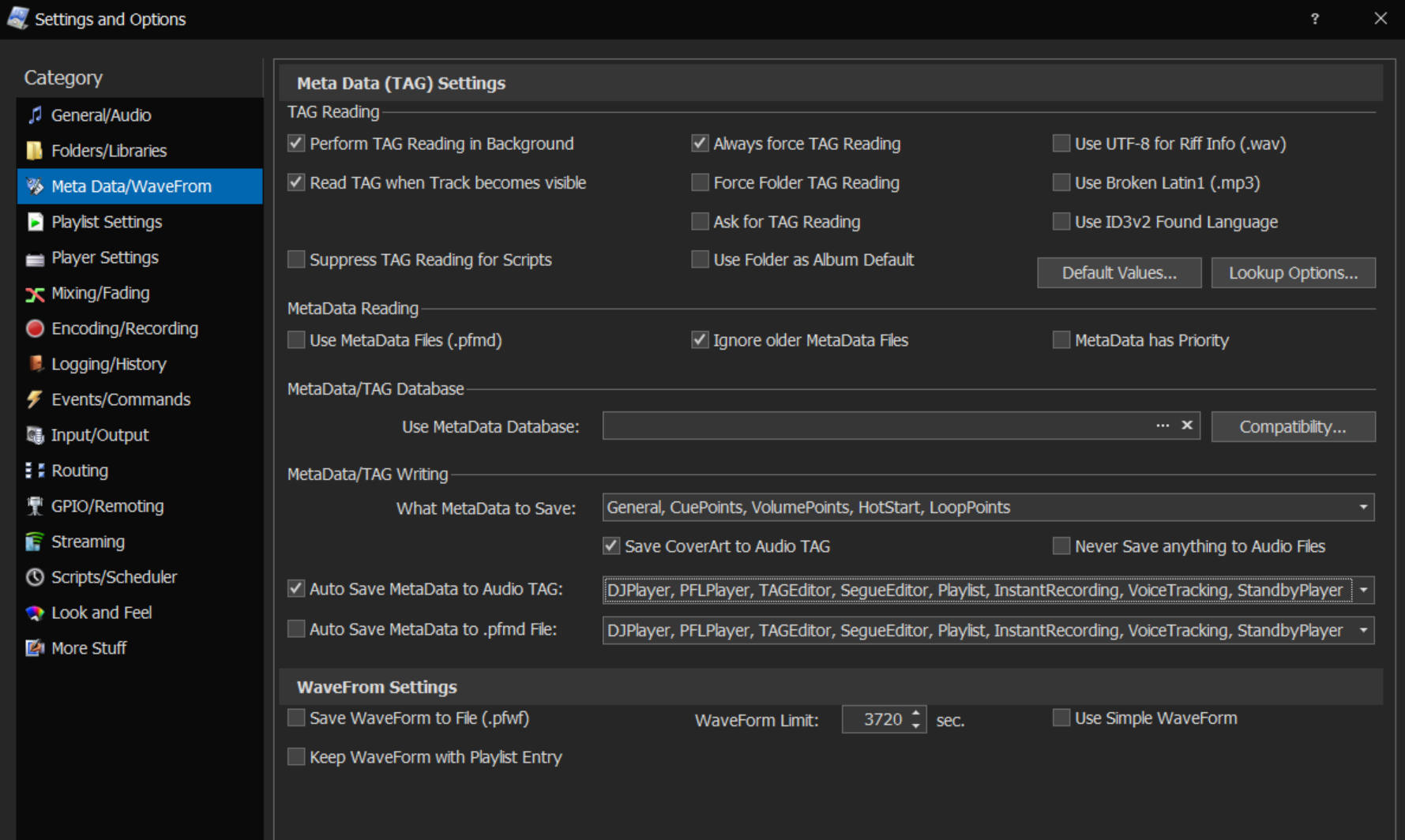

I've had 'Auto Save MetaData to Audio Tag' enabled for (amongst others) the SegueEditor.
Since I heavily use the segue editor to move tracks around, this could have caused my cue points to be changed right?
I've now completely disabled this feature and are contemplating how I should let PFOA handle my meta data. Perhaps I should not store anything in the tags but use .pfmd-files instead? What are the recommended settings?
I'm affraid to change settings since I really cannot grasp the PFOA meta data concepts and lost so much time just trying to get this right. I love the program but this part is way to complicated for my simple brain... :(
Yes that is correct. The Segue Editor would than save the TAG data automatically.
So you might safely disable that resp. only enable that for those elements where you for sure know that you want to do that.
I would not use .pfmd files, but always use the the TAG data.

One thing I found very confusing when editing a tag (ALT-3) that clicking 'Save' does not seem to store the tag into the MP3. You first need to click 'Save Meta Data Tag', then confirm the warning and then click 'Save'. Is there a faster way to edit tags directly from PFOA?
There is a difference between TAG data (standard values, like Title, Artist etc.; see here: http://www.proppfrexx.radio42.com/forum ... f=9&t=7#p9)
and meta data (which is all the rest, e.g. cue-points, options, track inserts etc.).
TAG data is always saved in the TAG Editor when you click on the standard 'Save' button.
Meta Data is (only) saved when:
- you have activated the 'Auto Save Meta Data to Audio TAG' and selected the related element (e.g. TAG Editor)
or
- you explicitly clicked on the 'Save Meta Data TAG' button
So as said above. I would not use .pfmd files but enable the 'Auto Save Meta Data to Audio TAG' for only those elements which you are sure you always want to automatically save the meta data to the audio's TAG data.
