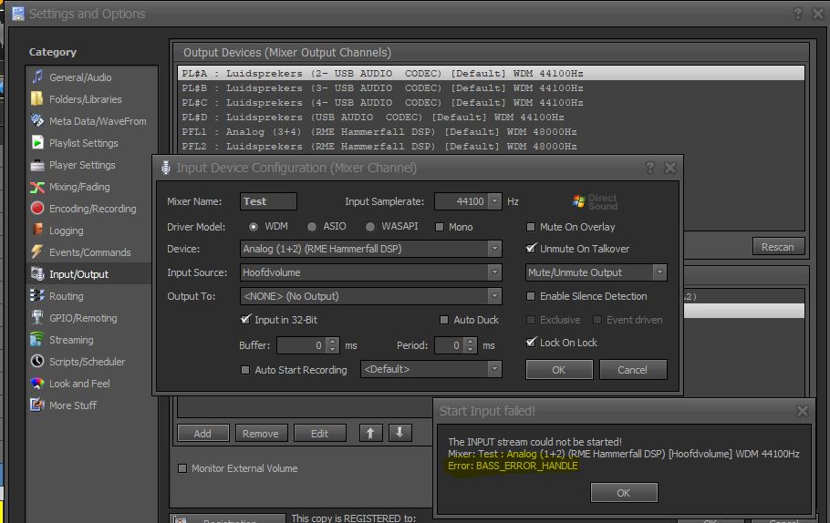

Dear all,
ProppFrexx version: v3.0.15.21
Since a couple of weeks (i suspect windows 10 update) i receive below error when adding Input Device for mixer inpur channels for this specific sound card (RME hammerfall DSP). Output channels are working fine and also other soundcards are working fine for in/output.
Any ideas
Thanks in advance

Note, that the v3 came to its end of life since many years! There is no support and no bug-fixes anymore. The one-year transition period to v4 is also over since a couple of years.
As such, it might be time to purchase the new v4.
But maybe the input device is already in use somewhere else? Or you try with the WASAPI mode, as WDM is anyhow just emulates on Win10. I

Dear Bernd,
Problem is fixed.
Deleted default.mixer file and rebuild mixer from scratch. Also updated soundcard with latest drivers. Everything is working fine now.
