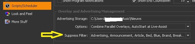

If you play the TOTH with the overlay player yes it can be done.
In general settings, section "Scripts/schedulars"in the overlay and advert group.
In the 'Suppress Filter' select all the media entry types which should be ejected/suppressed within the current playlist when an overlay is about to start.
This allows you to prevent, that these media types are played either directly before or after the overlay.
Note: This function is only in effect, if an Overlay has the 'ApplySuppressFilter' option set (which is an option in the Overlay Editor) as well as if this option is set!

We use the overlay player like this:
Newsopener
News
Jingle
Then the playlist starts.
If you use the setting i told before then there is not playing a jingle after the overlay. Make sure that you check the box in the overlay player “applySupressFilter”.
