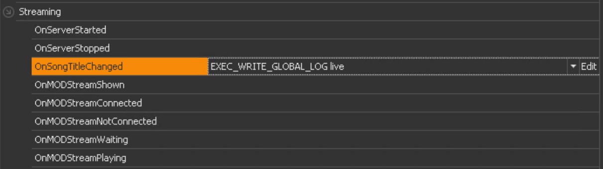

I've added EXEC_WRITE_GLOBAL_LOG to the Events/Commands on Streaming section like on attached picture.

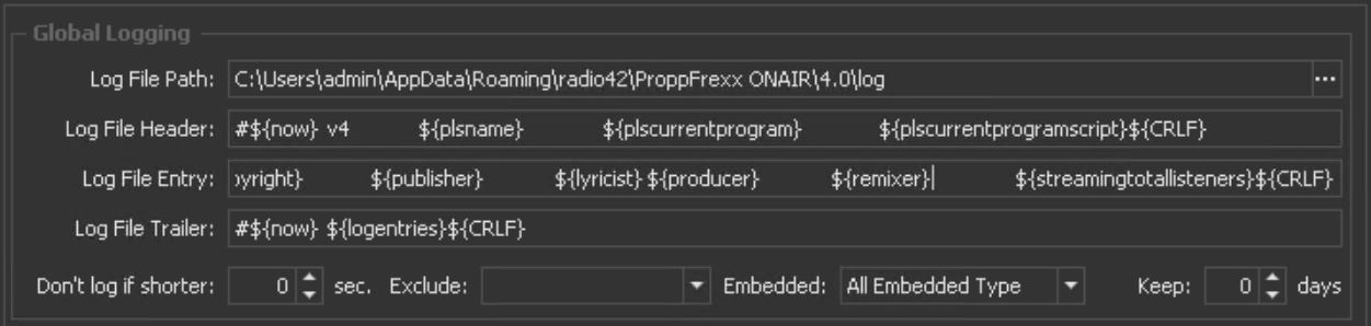

Also the ${streamingtotallisteners} macro at the end of the line of the Log File Entry in Global Logging section.
Please double check if there is no errors/mistakes.

Re: MODStream in statistic report
Use the OnSongTitleChanged event!
Post by kzlosnik »
I think now it is correct.
Yes in general this seams okay. Even if I don't fully understand the '...${remixer}| ${streamingtotallisteners}${CRLF}'
Shouldn't this just be: "...'...${remixer} ${streamingtotallisteners}${CRLF}'
Post by kzlosnik »
There was a cursor vertical line, not the character.
