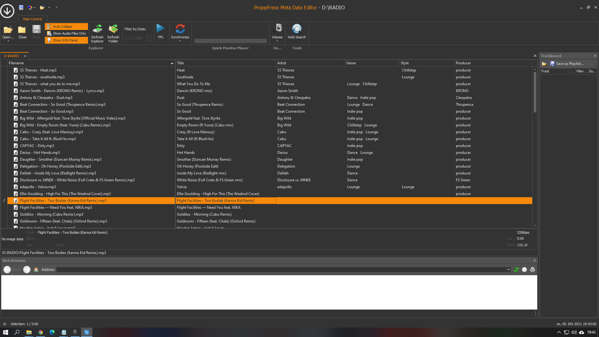

Hello, I have two problems, that might be connected.
first of all, when I edit a tag on a song through PFL player in tagger and save, column produce will get a "producer" written to it even though I didn't edit that field at all. I think the tagger may be corrupting the tag, because when I open such file in Mp3tag, the songs that have this field empty show a value producer/: but those that got srewed up in tagger have producer:
When I try to fix this, by loading all the tracks into tagger, selecting all that have "producer" deleting the value, then saving, the incorrect "producer" value is back upon reload.
seems to me, that whenever tagger saves, it breaks that tag field from producer/: to producer:

Hello, thanks for responding. produce is just a typeo. in the attached screenshot, you can see the tracks those that have "producer" in the Producer column were edited (but nothing was written in the Producer field) the last track I didn't event open in the player or editor. I just right clicked it, chose save tag and save file, then chose re-read tag and boom. "producer" popped up.
So basically, whenever I save meta tags and meta files, unless there is an entry in the Producer field, "producer" gets written in instead of staying blank.
in the second screenshot, you can see how that field looks in Mp3tag. If the tag was formatted to have that field, but with no entry, it would show "producer/:" like I saw on tracks that went through older version of Propp Tagger. Instead we have "producer:" because the slash is dropped, it shows up. Is what I think anyway. Im definitely no expert.

OK, I found a solution for the producer problem. Seems like the encoder used to create the mp3 files has some bug. I opend all the files in Mp3 tag and removed all tags. Now they behave ok in tagger. with or without the .pfmd files.
So sorry, probably not a tagger problem, seems like the tags were broken in the beginning. Sorry for leading you on a wild goose chase.
