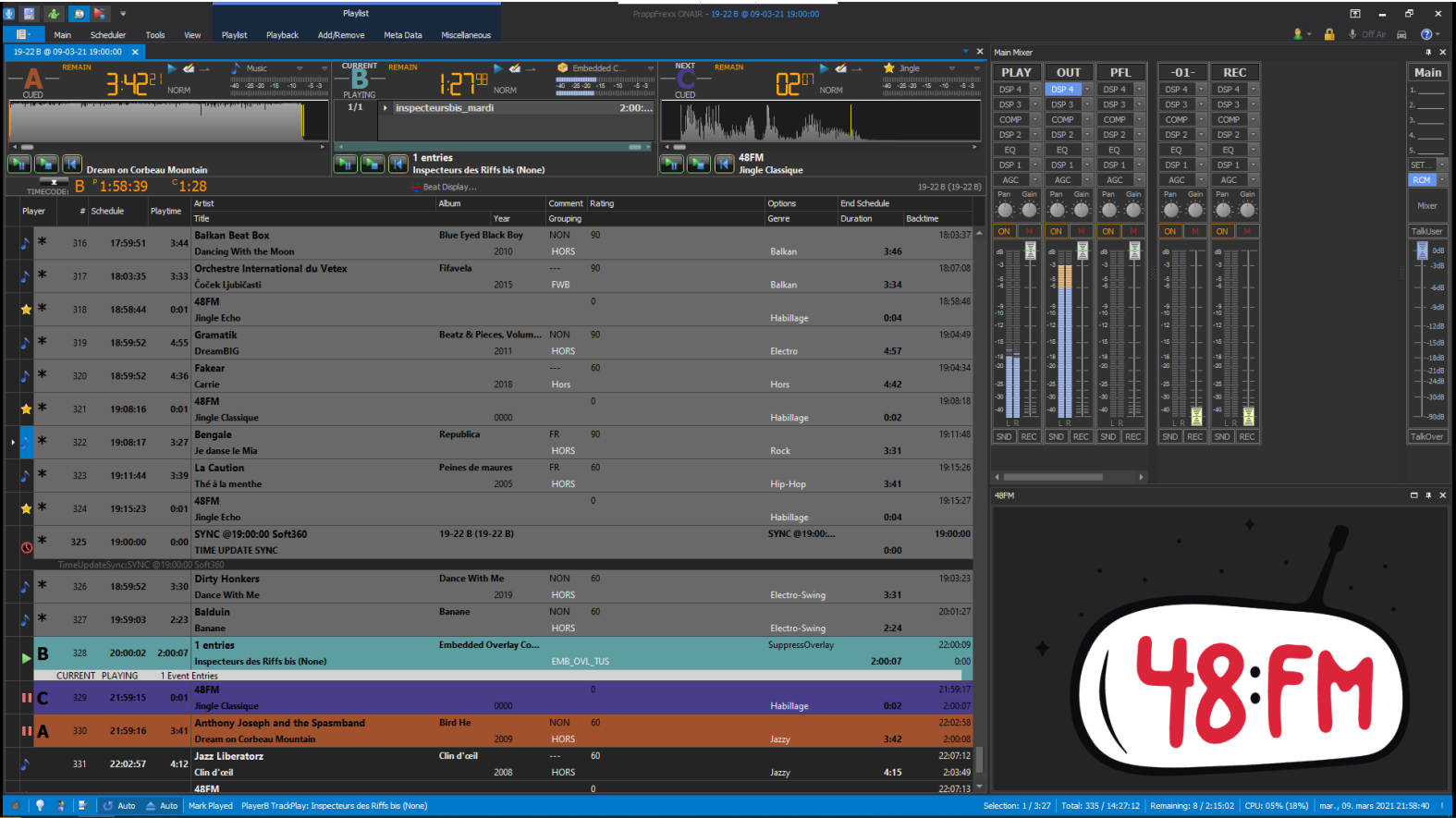

Sorry but that brings me to another issue...
Impossible to open the streaming monitor window. :-)
On screen I have the main playlist, main mixer and station logo.
Never checked before, but impossible to open any other windows.
Our setup looks like this :
It seems that the closed tabs can't be reopened ?!
Any idea ?
Posts: 9232
Re: Streaming settings not updating without restart
It can be! Except you have accidentally rearrange it, so that is not visible anymore!
Go to the general settings, section Look and Feel, click on the Reset: 'Layout' button - now you need to restart ProppFrexx (cloase it and reopen).
Or try to click on the 'View' ribbon tab and click on the 'Streaming Monitor' button - have you tried that?
