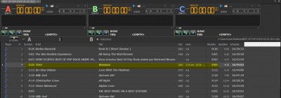

Impossible to save Hook for 3 tracks in the playlist. When i save the playlist (pfp) and i open then, erase all the hooks each time.

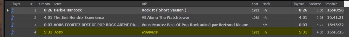

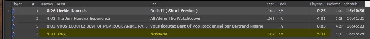

re open playlist but no hook is present
with hook then save playlist.
Posts: 9080
Re: problem with a playlist
I guess your problem is still, that some of the meta data is probably saved at different locations?!
Where is your hook data stored? In the .pfp playlist file or directly in the audio file?
